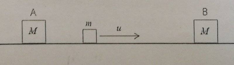

Both object A and B have mass M and are moving.
An object with mass of m and moving with velocity u collide with the object B elastically. (m < M)
Find the following after m collide with B
1) Velocity of m after bouncing back
2) Velocity of B
Then m collide with A and bounce back
3) The highest value of M/m that velocity of m is lesser than or equal to that of B
(Surface has no friction)
Using the Law of Energy Conservation and the Law of Momentum Conservation
##\frac{1}{2} m u^2 = \frac{1}{2} m v_1^2 + \frac{1}{2} M v_2^2##
##m u = -m v_1 + Mv_2##
After solving the equation, I get this
##v_1 = \frac{M - m}{M + m} u## (Answer for (1))
##v_2 = \frac{2 m}{M + m} u## (Answer for (2))
Then object m hit object A. The velocity of m then change into
##(\frac{M - m}{m + M})^2 u##
Velocity of m should be equal to that of B so m cannot reach B
##(\frac{M - m}{m + M})^2 u = \frac{2 m u}{m + M}##
##\frac{M}{m} = 2 + \sqrt{5}## (Answer for (3))
Is that correct?

Looks fine.
