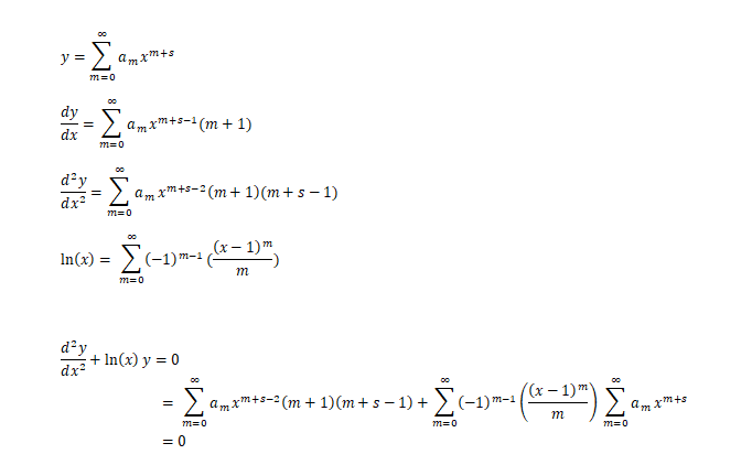

Finding the singular points for this differential equation

If d^2/dx^2 + ln(x)y = 0[/B]
included in attempt
I was confused as to whether I include the power series for ln(x) in the solution. It makes comparing coefficients very nasty though.
Handwritten-style typed derivation of a power series solution to y'' + ln(x) y = 0, with y = sum a_m x^(m+s), its first and second derivatives, the series for ln(x) in powers of (x-1), and the combined series set equal to zero.
Whenever I expand for m=0 for the a0 I end up with a pretty nasty expansion. Can somebody tell me where I'm going wrong here?
You're missing y on the left side.

I think you might be going about it wrong. Based on what you posted, the question is not asking you to solve the DE -- just find the singular points. Obviously you're not going to get a series in powers of x, because the DE is not defined at x = 0.
