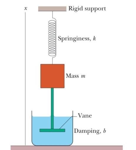

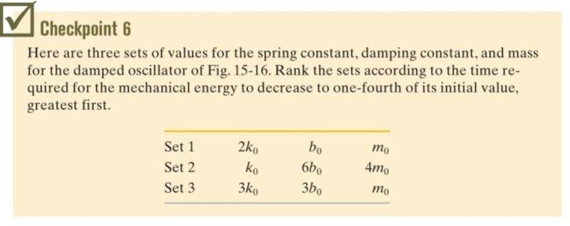

Here are three sets of values for the spring constant, damping constant, and mass for the damped oscillator of Fig. 15-16. Rank the sets according to the time re-quired for the mechanical energy to decrease to one-fourth of its initial value, greatest first.
This is from halliday and resnick chapter 15. Checkpoint 6. The answer says it doesn't depend on spring constant.
Note that they carefully ask about the percentage change of energy over time. They are not saying, as you claim thay are, that
"mechanical energy of a damped oscillator not vary with spring constant"
Where are they? What does Fig. 15-16 show?
Here it is

Rate of decay (λ) depends on the b/m relation. You are confused about the value of the initial energy, which is:
and the equation of energy in terms of time t:
edit: deleted some part of the reply due I provided the entire solution
