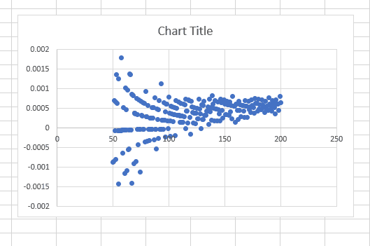

  • #122
this reminds me of slope field diagrams in a way, im guessing where the lin flattens out is terminal velocity? not sure that is correct thinking on my end because based on a terminal V calculator online, i get 598m/s based on the same numbers i used. I am probably jumping ahead
EDIT, i added a linear trend line

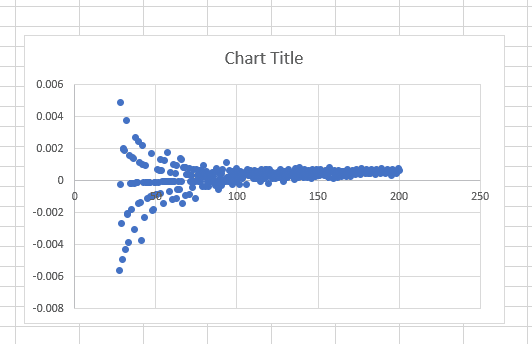

  • #124
LT72884 said:
At 50m/s.
At 55m/s a drastic change
This is why scale is really important. How large are these fluctuations when you step back and examine it. You are taking measurements with some sensor, that has some error. You aren't going to get perfection. How much does the average ##\beta## change from 50 -100 , vs 100- 150, vs 150-200? How much is the ##C_d## based on the average for each range?

  • #127
LT72884 said:
At 50m/s.
That looks like what I'd expect. In my experience (having done similar Cd estimation on some of my rockets), you get pretty noisy data but the higher speed average value ends up being pretty reasonable (and the 0.6 that you found does appear reasonable to me).
The multiple discrete lines of data points at lower speed is also expected - that's due to accelerometer resolution and the fact that at low speeds even with a fairly high Cd, acceleration is low (and thus measurement accuracy and precision are also low unless you had a much fancier and more expensive accelerometer).
  • #128

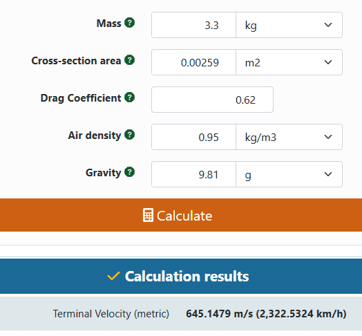

so what is happening at 200m/s with this graph? thats where the system settles too. Is this terminal velocity?
I am not sure if it is or not because using the Vt calculation using my 0.62 Cd, density, etc, i get that Vt is close to 600m/s

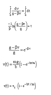

ok, cool. I have noticed i do not have 0 in my data for acceleration so im guessing its when acceleration is a different value.
post #40 is that not the DE?

  • #137
erobz said:
Firstly, that is a different equation altogether. If you want to solve for the velocity as a function of time you will have to solve the new differential equation (that you haven't yet derived like I asked)
But yes. Minds were changed along the way. You will find that to be a very real part of real world problem solving. You dive in with some idea, and many times the problem or question itself will evolve as you begin to untangle things. Nothing in real world is "solve this using a,b,c,d, assuming d,e,f,g". It's quite literally...Here is this problem...we think, you figure out the rest! I had nothing more than an approach idea wasn't immediately sure what the exact answer was, or how the dots would connect. I started down a road that would have been a real back breaker...and then I had a moment of "clarity" along the way...a "duh" moment if you will.
If you are just after terminal velocity, then solving for ##v(t)## via an integration is not necessary. You can, if you want. Like I said. Its not that equation you've written out above. That is for linear drag models.

  • #144
No, that's just where you're going fast enough to have a decent amount of drag-induced acceleration, giving you fairly clean data. Cd should be (largely) independent of speed in the subsonic regime for a rocket-shaped object, and that's just where your data is good enough to observe that.
(For an example of what much cleaner drag data looks like for a rocket, here is an actual measured drag profile from a friend of mine).
thanks
The biggest problem with that is that 600m/s is well supersonic, and thus your real terminal velocity would be lower thanks to the drag rise that occurs at mach (as seen in my sample data above). I'd also note that your very high sectional density is actually making your data a lot muddier - since you're limited by accelerometer resolution, you'd get much better data with a rocket with higher drag relative to weight, but obviously that goes against the general design goals here.
Also, I'm curious what motor you used here, since your frontal area makes this seem like a 54mm MD rocket, and it's not exactly common to get to 20,000 feet on a 54mm motor.
