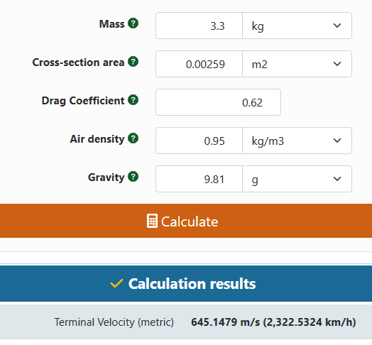

  • #62

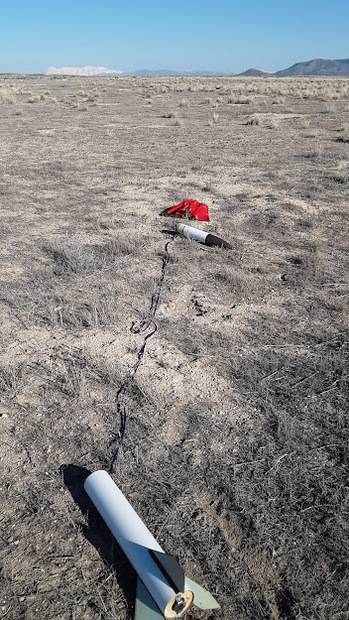

the chute/shoot doesnt deploy for 24.6 seconds and apogee hits at 27.1 seconds. So the chute pops right before apogee. The chute is below the nose cone.

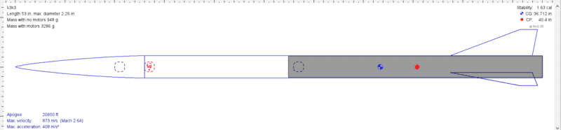

This image was a test launch to 1 mile
15 foot shock cord, 5 foot chute
i can get permission to allow a rocket to go ballistic but it has to be a smaller rocket haha.
as for the equation... Im not even sure where to start of what it would look like.
F=m(dv/dt)
F=drag -gravity
m(dv/dt)=Fd-mg
then not sure where to go from there haha

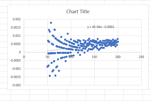

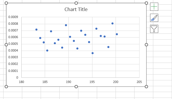

  • #79
erobz said:
I don't know exactly the numbers, but I would expect something negative greater than ##g## given the equation:
$$ \frac{dv}{dt} = - \left( g + \frac{\beta}{m}v^2 \right)$$
solving for B i get:
is that how i needed to solve for it?

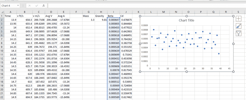

I know mass of the rocket, acceleration of the rocket, gravity, launch time and temp, rho, and velocity
where dv/dt is, do you just want me to use the acceleration values there?
  • #80

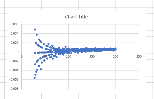

I want you to take the average acceleration across each time step (just for the truncated data).
##a_{avg} = \frac{ v_2 - v_1 }{ t_2- t_1}##
and arithmetic average velocity over the same time step
## v_{avg} = \frac{v_1 + v_2}{2}##
You are then going to plot ##\beta## vs ##v_{avg}##

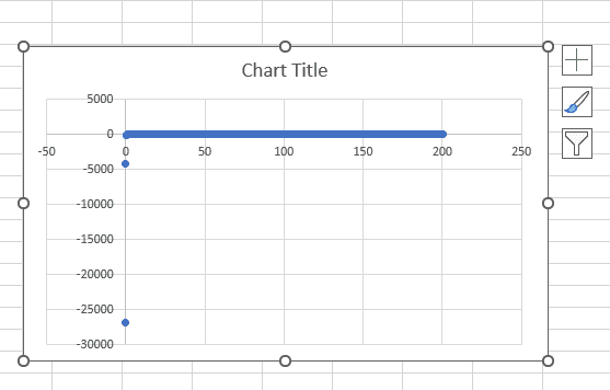

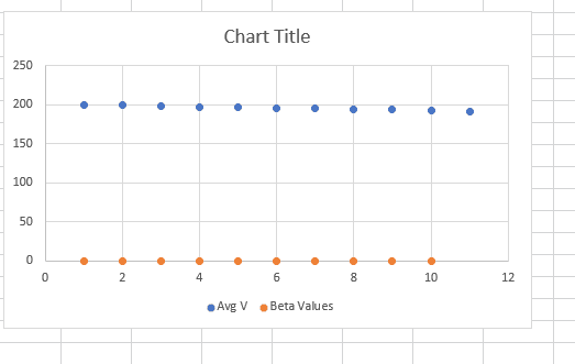

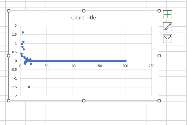

  • #86

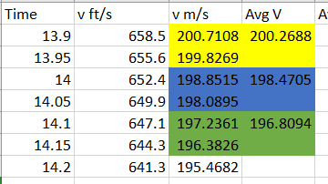

ok, there are 2 ways i could do this, which one is the best? i have this way
the 2 yellow velocities are averaged, the 2 blue and 2 green are as well. OR, i can do
(200.71+199.82)/2
(199.82+198.85)/2
(198.85+198.08)/2
(198.08+197.23)/2
  • #87
(200.71+199.82)/2
(199.82+198.85)/2
(198.85+198.08)/2
(198.08+197.23)/2
Just start at the cell D3 . Write all the formulas as:
in cell D3:
Formula: = (C3 + C2)/(2)
And just drag it down. Same with the acceleration (different formula).
in cell D3:
thats how i did it at first, by dragging the formula down. But i noticed it used a previous value so wasnt sure that would mess up the data or not, but i will go ahead and do it the way i was going to haha
  • #89
move the formula down one cell. Then just stop it at the end. you are going to truncate the data a bit more to remove some outliers, or you could remove them point by point if you feel like it.
  • #90
cjl said:
It comes from the equation you should be already familiar with, namely, Fd = 1/2*rho*v2*Cd*A.
At first approximation, 1/2, rho, Cd, and A are all constant, so it simplifies down to Fd = some constant * v2.
Now, for this, you probably have to account for varying air density, so it would be good if you could look up an atmosphere model (or better still, if you know the temperature that day, a temperature corrected atmosphere model), and then you'll want to basically try to fit your deceleration data to a model using this formula, with 1/2 (obviously), rho (from your atmosphere model), A (from whatever your chosen reference area is), and v2 all known (you know v from your data, which incidentally you should use accelerometer based speed rather than baro based speed if possible, it's much more accurate), and thus you can solve for Cd.
You know Fd because you know the burnout mass of your rocket and you had an accelerometer onboard, though you're going to (at least in my experience) have issues getting any kind of accurate data below a few hundred mph because you start getting limited by accelerometer discretization at that point. Because of this, you can rearrange your equation to Cd = Fd/(1/2*rho*v2*A), and then just solve for your Cd vs V curve.
(Also, the Raven is a great little altimeter, so I'm glad to hear you're using it)
sorry for late reply. have had some crazy issues with my train rides. My train to school had to get towed by another train haha, then yesterday a truck fell off the overpass onto the train.
Ok, so how do i know Fd based on burnout mass?
thanks much.
I also preferer to use an accelerometer over barometric pressure readings for velocity.
for the quadratic drag, i see what they did. Beta is just a constant of all the constants
