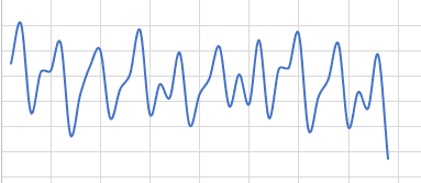

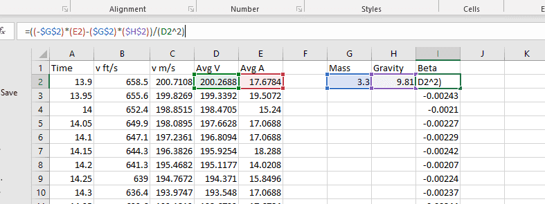

here is what i have for beta, using avg acel for dv/dt. B=(-ma-mg)/v^2
the numbers are odd, and when i plot it.... man it looks nasty

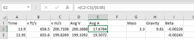

i used a=(v2-v1)/(t2-t1) but if it needs to be -, then i will switch it around
  • #96
If you did use that formula you would be getting a negative value, and you aren't.
exactly. But excel shows that i am using the correct formula. Ill just reverse the C3 and C2 values, that will produce negative numbers. I just dont know if beta is correct.
if i let B=(rho)(Cd)(Ar)(0.5) and solve for cd, i get 0.72 for the first entry. Now, Cd does change a lot during a flight due to many factors. So a plot of Beta should look almost like a switch back type trail..

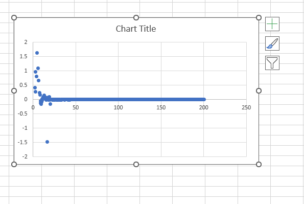

B= (Cd)(Area)(rho)(0.5)
Beta is all the constants. From here i just plug in what i have and get the Cd. Bellow is the plot of beta.

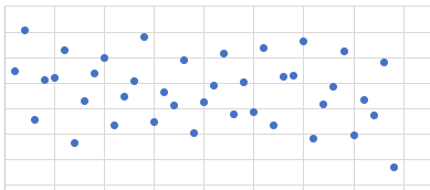

Yeah, thats noise. Just do scatter plot, no line.
  • #102
that is a scatter plot. Just connected with a line is all. if i remove the line, its the same mess haha

How about some axis and scale?

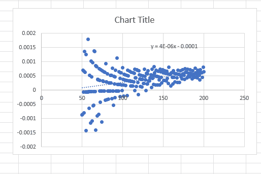

y axis is values where beta falls, x axis is the cell number. I have cells 2-39 selected
  • #105
even plotted against velocity as the x axis or even as a data set, its still looks scattered

You are supposed to be plotting ##\beta## vs ##v_{avg}##? That is ##\beta## vs time; It's not really as useful. The purpose of this is to determine if ##\beta## depends on the velocity "##v_{avg}##"

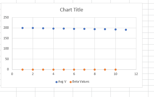

correct, and when i select that data, the velocity is a linear function with negative slope, and B is linear with 0 slope.
So somewhere, either excel is trying to be "smart" and adjust the data or i have selected the wrong data haha, which is possible

You've plotted ##v_{avg}## vs time as a separate series. Delete the chart. Put in a blank one and right chart area - click "select data"
##v_{avg}## is the ##x## values
##\beta## is the ##y## values

then what will the plotted data be? Im not sure i follow, but i will change the axis to match what you have said.

i get the exact same thing

It will be ##\beta## vs ##v_{avg}##

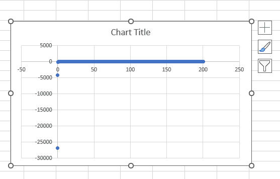

yup, something is not right. I selected all the average velocities as X and Beta as Y and this is my plot

Thats because of those data points that are near -30,000! Just chop the data off below 20 m/s.

At 50m/s.
At 55m/s a drastic change
