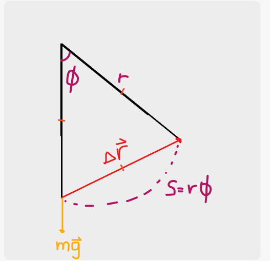

  • #31

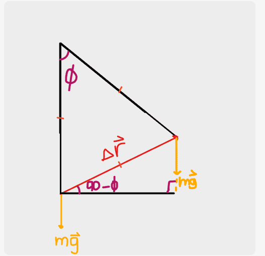

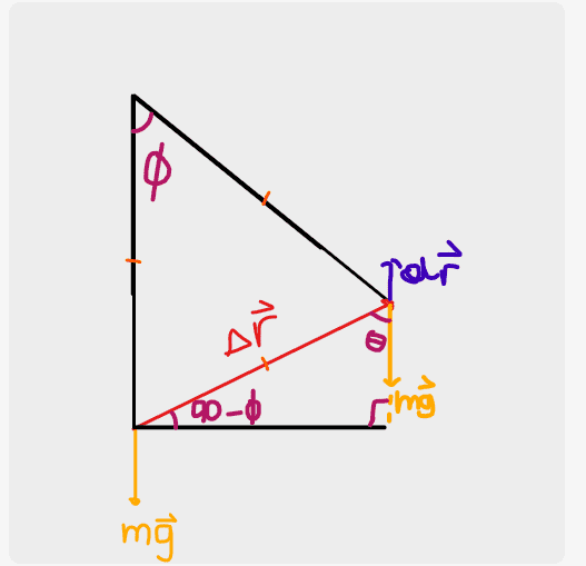

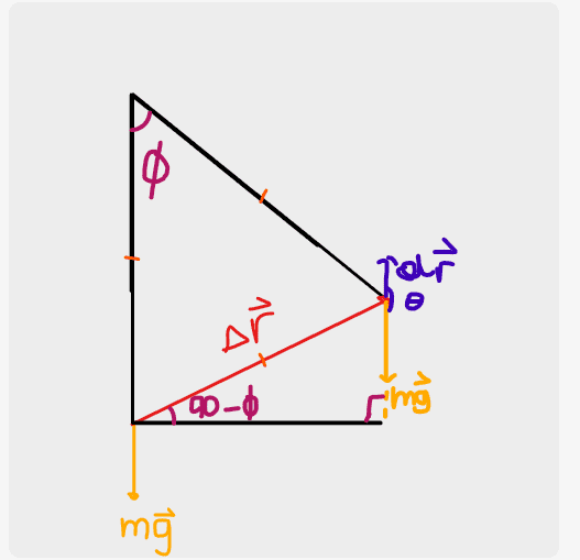

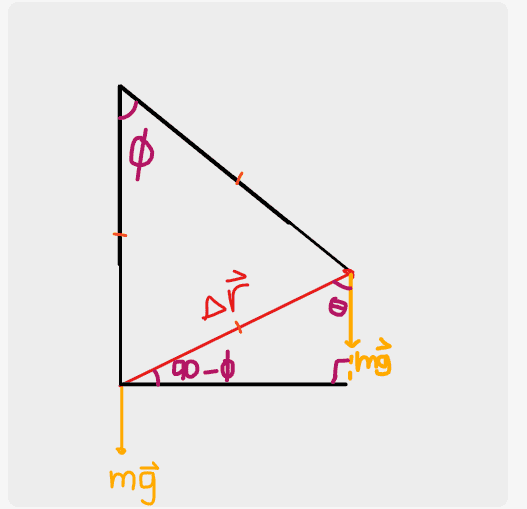

haruspex said:
More accurate in some ways, but you have not marked in any angles, and you have moved the mg line over to the left.
Thank you for your reply @haruspex ! I moved the mg line to the left so I could see from exterior angle theorem that ##\theta = 120~degrees##.
What way were you going to find the angle?
I think I also found ##\vec {\Delta r}## vector correctly now.
To find it I split my equilateral triangle into half to form a right angle triangle
I then found the opposite to be 6m so the total displacement must be 12m. But I guess I did not need to do that since the triangle has equal sides.
Many thanks!

Ok, so what is the angle between the force mg and the displacement ##\vec r##?

  • #33
"Equilateral" means all sides are the same size (equal sides). You don't need to split it and to form right angle triangles. You seem to have a tendency to pick the most complicated ways to solve things., 😃

Callumnc1 said:
Thank you for your replies @haruspex and @Lnewqban!
F is the force of gravity acting on spider man and W is the work done by the force of gravity on the spider man.
How are those two forces different?
Acting only vertically, weight can only resist vertical displacement between lowest and highest points.
The muscular energy from Spiderman is the only cause of the horizontal displacement (r→), about which the problem is not asking.
Re-visit post #3 and focus only on pure vertical work.
  • #36
Would the response be different if Spiderman just climbs a 6 meters high wall and then walks horizontally on it other 10.4 meters?
  • #37
Thank you for your reply @haruspex! The angle is 120 degrees

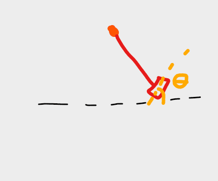

  • #44
Lnewqban said:
"By repeatedly bending at the waist, ..."
Is there any displacement in the direction of tension?
Thank you for your reply @Lnewqban !
I don't think so since spider man can be modelled as a particle in circular motion when he bends his waist (assuming COM at waistline). I think the displacement is tangent to the tension.
Many thanks!

  • #47
Not sure what your point is. The supposition is that he works it up like someone on a swing.
You cannot model an object which bends at the waist as a point-like object. Nor can a point-like object pump up the amplitude of its swing. It will just swing back and forth in an arc with a fixed amplitude. It has no degrees of freedom to influence anything.
With an extended body, one can pump a rope or swing in either of two modes.
Mode 1: You utilize the angular momentum of your body to shift the ropes or chains fore and aft as you swing. You shift aft during the forward swing and fore during the aft swing. This works for low amplitudes, though it is rather difficult to get started. From a seated posture, the main things you are doing is leaning back with legs extended forward and pulling back on the chain or leaning forward with legs folded beneath the seat and pushing forward on the chain. From a standing posture, the main thing you are doing is leaning forward and pushing forward on the chain or leaning back and pulling back.
Mode 2: You shift your body up and down. Suddenly up at the bottom of the stroke. Slowly down anywhere near the end points. The more work you feel like you are doing, the more energy you are pumping into the system. This works exceptionally well at high amplitudes and is best done from a standing posture.
As a child, I had a chance to practice extensively since we had a longer-than-usual swing on one of the elm trees in our back yard. Maybe 15 feet of chain. It had a flat wooden seat and could be pumped from either a standing or a seated posture. From a standing posture, it was possible to get the chains a bit above the horizontal. I do not know how our parents failed to have heart attacks watching us every day.

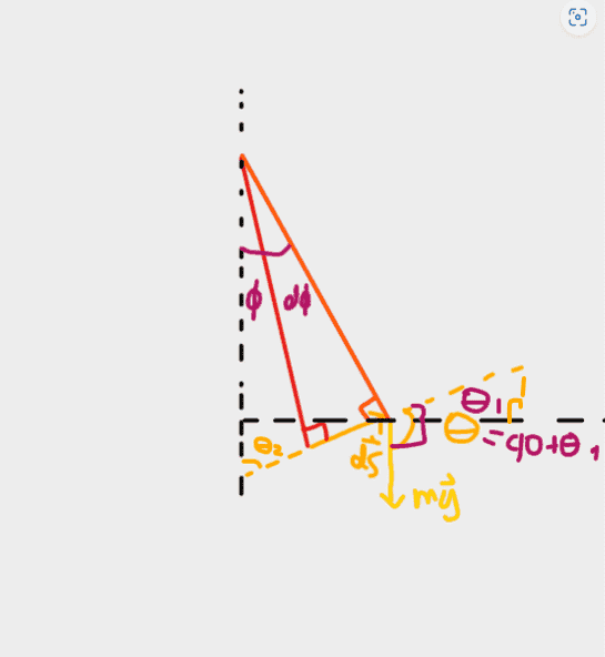

haruspex said:
If the ant accelerates at a and the bob at A the other way, the torque balance at the pendulum pivot gives ##MA(R+r)=maR##. So the ratio of speeds is ##M(R+r):mR##, and the ratio of distances travelled is the same.
When the ant has gone distance r (roughly - the bob moves the other way so it will be a bit less), the bob has moved ##\frac{mrR}{M(R+r)}##. So the net movement of the mass centre is ##\frac{mr-M\frac{mrR}{M(R+r)}}{M+m}=\frac{mr(1-\frac R{R+r})}{M+m}=\frac{mr^2}{(M+m)(R+r)}\approx \frac{mr^2}{MR}##.
Thank you for very much your reply @haruspex !
Sorry, I am having trouble visualizing this situation, could you kindly draw a diagram? I think this will also help me understand why angular momentum is not conserved in this situation
Many thanks!
