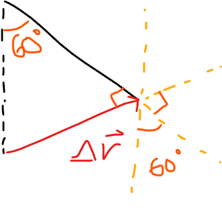

During the part of the process I described, the ant running to one corner, I took angular momentum as conserved. But the result is that the mass centre of the ant+bob is displaced from being vertically below the pivot. So now gravity exerts a torque about the pivot.Callumnc1 said:Thank you for very much your reply @haruspex !
Sorry, I am having trouble visualizing this situation, could you kindly draw a diagram? I think this will also help me understand why angular momentum is not conserved in this situation
Many thanks!

member 731016
Ok thanks you for your reply @haruspex!haruspex said:During the part of the process I described, the ant running to one corner, I took angular momentum as conserved. But the result is that the mass centre of the ant+bob is displaced from being vertically below the pivot. So now gravity exerts a torque about the pivot.
That helps a bit more :) I will draw a diagram of the situation you describe then post it soon. I find diagrams quite helpful for understanding the setup.
Many thanks!

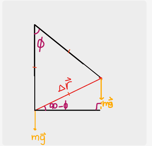

member 731016
Thank you for your reply @haruspex !haruspex said:If ϕ is the angle between the vertical and the rope then S=rφ.
When ϕ=0, what is the angle between ##\vec ds## and the gravitational force?
True I did not realize that s =rφ.
I should then take the of the new arc length equation with respect to phi to get ##\frac{ds}{d\phi} = r##
When ##\phi## is zero, then ##\theta## the angle between ##\vec {ds}## and ##F_g## is 90 degrees.
Are you trying to get me to find the relationship between ##\phi## and ##\theta## by considering a few physical situations?
If I consider the second case where ##\phi## is 90 degrees, then the angle between ##\vec {ds}## and ##F_g## is 180 degrees, correct?
Is there a way to find the relationship between ##\phi## and ##\theta## without considering intuitive cases along the circular path?
Many thanks!

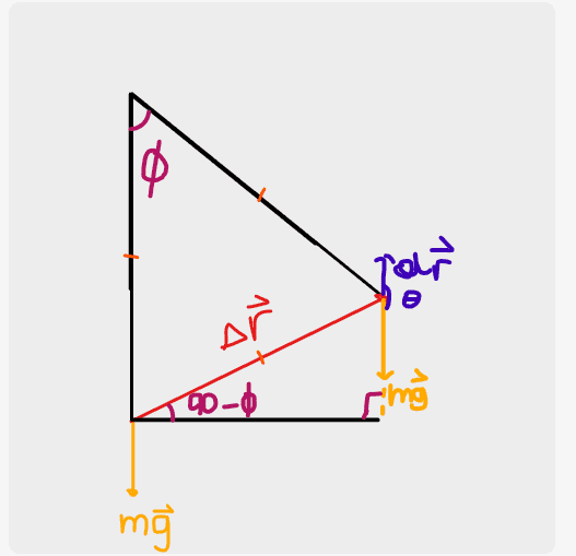

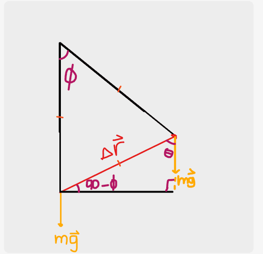

member 731016
Thank you for your reply @haruspex !haruspex said:Of course: draw the right diagram. The special cases are just an easy way to check your answer.
If you thought you had proved a different relationship, try to see where that proof went wrong.

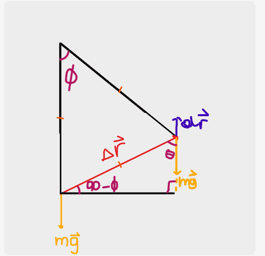

Based on my special cases in post #81,
1. ##\phi = 0## then ##\theta = 90##
2. ##\phi = 90## then ##\theta = 180##
It looks to me like the relationship is ##\theta = \phi+ 90## so theta is always a phase shift of 90 degrees ahead of phi.
I will draw a diagram again to prove this and post it soon!
Many thanks!

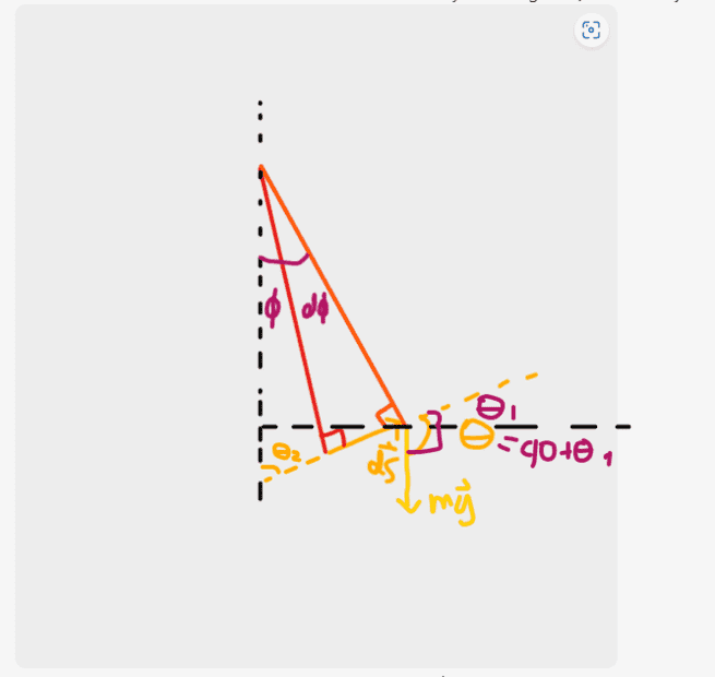

member 731016
Here is are my diagrams @haruspex
Could you please give me some more guidance, I am still getting ##\theta = \phi##
But I guess I'm meant to be looking at differential displacement so I can see here that ##\theta = 180##
many thanks!
many thanks!
- 42,981
- 10,573
You have drawn ##\theta## as the angle the final displacement makes to the vertical. You defined it as the angle the displacement element ##\vec ds## makes to the vertical at an intermediate point.Callumnc1 said:Here is are my diagrams @haruspex
many thanks!
Draw a diagram with the rope at two angles to the vertical, ##\phi## and ##\phi+d\phi##.
The displacement element is length ##r.d\phi##. Note that it is at right angles to the rope.
member 731016
Thank you for your reply @haruspex !haruspex said:You have drawn ##\theta## as the angle the final displacement makes to the vertical. You defined it as the angle the displacement element ##\vec ds## makes to the vertical at an intermediate point.
I guess it sort of makes sense to consider incremental changes in phi if we are trying prove the change in theta. I will try that!
Many thanks!
member 731016
Homework Helper
- 13,438
- 8,113
##ds## is (or behaves like) an infinitesimal. The incremental displacement is infinitesimally close to being at right angles to both the initial and final angles. Its angle differs from the perpendicular by only ##d \phi## at most.Callumnc1 said:I'm not sure if the displacement vector makes at right angle with the dark orange line (finial rope position)
But that is window dressing. Surely you are after the incremental work done. This should be the vector dot product of the force of gravity, ##\vec{mg}## and the incremental displacement, ##\vec{ds}##.
member 731016
Thank you for your reply @jbriggs444 !jbriggs444 said:##ds## is (or behaves like) an infinitesimal. The incremental displacement is infinitesimally close to being at right angles to both the initial and final angles. Its angle differs from the perpendicular by only ##d \phi## at most.
Oh ok that makes sense, now. I have added that too my new diagram (which is very not too scale):
Yes I think I am after the incremental work (## dW = \int_{\phi_1}^{\phi_2} Fr\cos\theta~d\phi ##) in terms of phi which I will integrate from ##\phi_1 = 0## to ##\phi_2 = 60## (Where ##\theta## is the angle between the differential displacement and spider man's weight).
Would you please know how to get theta in terms of phi from the diagram? I think (by considering two cases from post #83) that ##\theta = \phi + 90##
Many thanks!
member 731016
I think I may have found the answer!!!
First method:
If we start with the big triangle,
Then,
##\phi + d\phi + 90 + \theta_2 = 180##
##\theta_2 = 90 - \phi - d\phi##
Now for the small triangle,
##90 + \theta_2 + \theta_1 = 180##
## \theta_1 = 90 - \theta_2##
## \theta_1 = 90 - (90 - \phi - d\phi)##
## \theta_1 = \phi + d\phi##
Therefore since ##\theta = 90 + \theta_1## (since ##theta_1## is vertically opposite)
Then ##\theta = 90 + \phi + d\phi ≈ 90 + \phi## since ##d\phi## is a differential
Second method:
I believe you could have also found ##\theta_2## from the medium size triangle,
Where in this case
##\theta_2 = 90 - \phi##
##\theta = 90 + \phi## without having to make the approximation in the first method
Is my proof for ##\theta = 90 + \phi## geometrically correct?
Many thanks!
First method:
Then,
Second method:
Where in this case
Many thanks!
