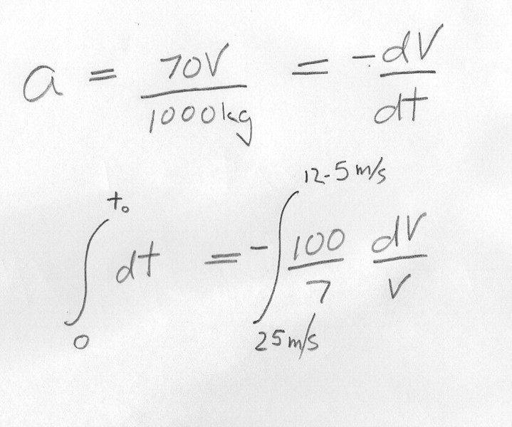

A 1000kg boat is traveling at 25 m/s when its engine is shut off. The magnitude of the frictional force f between the boat and the water is proportional to the speed v of the boat: f=70v, where v is in meters per second and f is in Newtons. Find the time required for the boat to slow to 12.5 m/s.
F=ma
a(t)=v'(t)
70v = (1000 kg) * a
a(t) = 70v(t) / (1000 kg)
However, after this point I don't know what to do. I can't use the formula v2 = vo2 + 2a(Δx), because I don't know Δx. I don't know how I would find the anti-derivative of a(t), since a(t) is defined in terms of v(t). What am I missing?
Does this look right?
It probably is, but I don't understand it. We haven't gotten that far in ap calculus yet, so I'll ask my teacher about how that works tomorrow. Thanks for the help!
