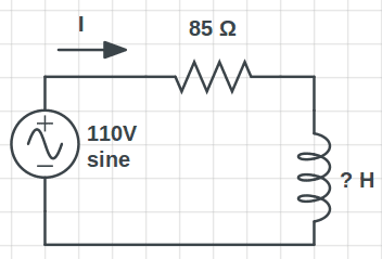

Here is my attempt at KVL:
$$0={ -\overrightarrow { V } }_{ AC }+85\overrightarrow { I } +{ V }_{ L }\overrightarrow { I } \\ \\ { \overrightarrow { V } }_{ AC }\quad seems\quad to\quad be\quad impossible\quad to\quad find\quad because\quad the\quad angular\quad frequency\quad was\quad not\quad given.\quad \\The\quad amplitude\quad is\quad 110V.\\ { V }_{ L }=j\omega \cdot ?\cdot \overrightarrow { I }$$
I regret using a question mark, ?, as the variable for the inductance of the inductor but it is too late to change now.
You are not given component values for the resistor and inductor, you are only given the voltage across the resistor. So in your diagram the "85 Ω" is not correct. That should be "85 V" for the potential drop across the resistor. As a result your KVL equation is also not right.

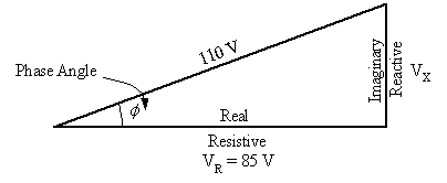

Let's take a slightly different approach. When you have a series circuit with reactive components (capacitors and/or inductors) drivin by some current I, then there will be a phase angle between the net voltage and the current. While the instantaneous voltage across the resistor will always be directly in phase with the current according to V = IR, the voltage across the reactive component will be out of phase with the current. You can represent the resulting mathematics with a voltage triangle.
This is essentially what's known as Phasor addition. The net voltage phasor is the 110 V on the hypotenuse. As you can see, the the Reactive (imaginary) component of the voltage phasor is at right angles to the Resistive (real). The components add just like the sides of a triangle, hence the ##110^2 = V_R^2 + V_L^2## equation.

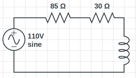

What if the circuit is slightly more complicated like below?
$${ V }_{ L }=\sqrt { { (85+30) }^{ 2 }+{ 110 }^{ 2 } }$$
Is that right?
Nope. The units in the terms are not the same. 85 and 30 have the units Ohms (Ω). The 110 has units Volts (V).
Did you mean for the numbers above the resistors to be the voltage drops across those components?

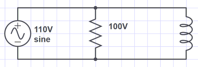

Last try:
$${ V }_{ L }=\sqrt { { 110 }^{ 2 }+{ 100 }^{ 2 } } $$
Sorry, nope again. Components in parallel all have the same potential difference across them. In this case VL = VR = 110 V
But I thought there's a difference between resistive voltage and reactive voltage? Aren't they orthogonal in that right-angled triangle you drew? How can they be equal? Could you maybe draw a vector representation of VL or VR?
Edit: Would I be right saying that the magnitudes are equal? i.e. both have a magnitude of 110V but VL has 110V in the imaginary direction and VR has 110V in the real direction?
In series, yes, there's a difference in the voltages. In parallel there cannot be... they are connected to the same nodes and any given node has the same potential everywhere. In a parallel connection it's the currents that can have different phases.
In a series connection the components all have identical current (it's a single continuous current path), but may have different voltages with different phase angles. In a parallel connection the components all share the same potential difference, but may have different currents with different phase angles.
In a series RL or RC circuit the current is the same for all components and the reactive components have a voltage phase angle of +/- 90° with respect to the current.
In a parallel circuit the voltage is the same for all components and the reactive components have a current phase angle of +/- 90° with respect to the voltage.

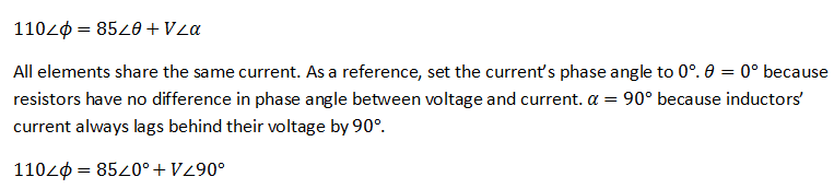

Ah, that clarifies a lot and I feel like I finally understand it. Of course, in a RL Parallel circuit, the voltages would all be the same (with the same phase angle) and the phase angles would be different in the current because the impedance must be completely resistive for resistors and completely reactive for inductors.

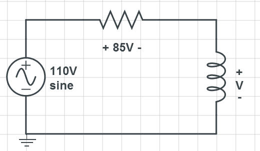

For anyone reading this in the future, this is how I would now solve this problem.
First, draw a diagram:

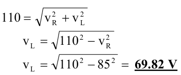

With basic series addition:
And now we can draw this diagram to solve for V (labelled Vx in the diagram):
