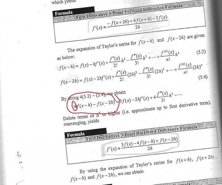

Can someone explain why for the first derivative 3 point forward difference formula is 4f(x-h) - f(x-2h) ??
Why it's not f(x-h) - f(x-2h) ?
Is there anything wrong with the notes ?
  • Textbook page showing Taylor expansions of f(x-h) and f(x-2h), with the circled line 4f(x-h) - f(x-2h) = 3f(x) - 2hf'(x) + 4(f'''(x)/3!)h^3 - ... and boxed first-derivative 3-point forward and backward difference formulas.

please refer to the circled part ... it's really ##4 f(x-h)-f(x-2h)##

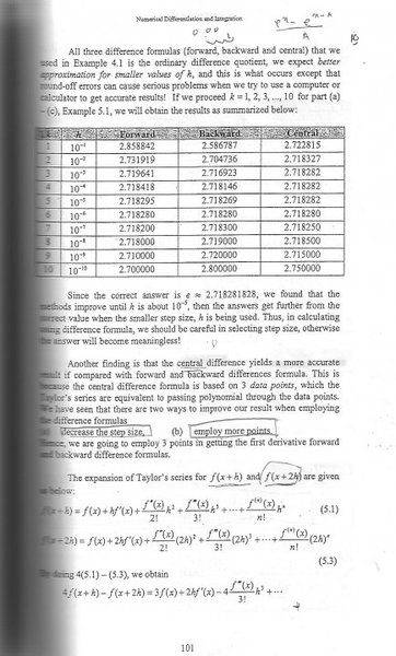

  • Scanned page 101 from Numerical Differentiation and Integration, showing a table of forward, backward and central difference approximations of e for step sizes h from 10^-1 to 10^-10, followed by Taylor series expansions of f(x+h) and f(x+2h).

  • Photo of a printed textbook page showing the derivation of the first derivative 3-point forward difference formula, with boxed formulas, Taylor series expansions of f(x-h) and f(x-2h), and a circled step combining them.

OK, but your first message said nothing about the "circled part"---that makes a difference. So, I have a question for you: have you taken the Taylor expansions for ##f(x-h)## and ##f(x-2h)## and performed the calculation of ##4f(x-h) - f(x-2h)?## Did you get a different answer from that in the notes?

The reason that your equation is not correct is that this is a first order accurate approximation, and the result they are trying to obtain is supposed to be accurate to terms of 2nd order in h.

No , i get the same as the notes , my question is why should we use 4f(x-h) ? why can't we use f(x-h) ?
Can you explain further ? I still didnt get it

In my judgment, it is well explained in the visual you provided.

Why we should use 4f(x-h) ? It's not explained in the notes

You can use what works, and 4f(x-h) works. Try it for yourself, without the "4", and see what happens.
In fact, suppose you want a finite-difference formula of the form
$$ f'(x) \approx \frac{1}{h} [ a f(x) + b f(x-h) + c f(x-2h)].$$
Expand out the numerator as a series in small ##h## and you will get something of the form ##(a+b+c) f(x) + B h f'(x) + C h^2 f''(x) + O(h^3),##
where ##B## and ##C## are some expressions in ##a,b,c##. You want a numerator expression of the form ##0 f(x) + 1 h f'(x) + O(h^2)## (so that the ratio is ##f'(x)## to first order in ##h##). In other words, you want ##a+b+c=0## and ##B = 1##. After evaluating ##B## in terms of ##a,b,c## you will have two equations in the three unknowns ##a,b,c##, and can solve for ##b,c## in terms of ##a##. If you make different choices for ##a## you will get different "finite-difference" formulas for ##f'(x)##. See if you can figure out what value of ##a## gives you ##1 f(x-h)## in your finite-difference formula.

What they do is eliminate the term involving f'' from the two equations, and solve for f'. This results in a finite difference approximation that is accurate to terms if h2.

why there is a need to eliminate f'' from the equation ?

I tried f(x-h) - f(x-2h) , i get -h'f(x) + (3 /2!) (f"(x) h^2) + (3/3!)(f"'(x)h^3) + ...
I didnt get (a+b+c)f(x)+Bhf′(x)+Ch2f′′(x)+O(h3) though

Because otherwise you would find that the final finite difference equation would only be first order in h. Try any other linear combination of the two equations and see what you get for f'

That is because you ignored what I wrote. I wrote ##a f(x) + b f(x-h) + c f(x-2h)##. I suggest you do the same, then tell us what you obtain.

Do you mean f(x) + f(x-h) - f(x-2h) ?
If so , i get f(x) -h'f(x) + (3 /2!) (f"(x) h^2) + (3/3!)(f"'(x)h^3) + ...

Why would you ask that? Since when does ##a f(x) + b f(x-h) + c f(x-2h)## suddenly become ##f(x)+f(x-h)-f(x-2h)?## (Ok, it would happen in the one case where we choose ##a=1, b=1, c=-1##, but I said no such thing.) I left ##a,b,c## as unevaluated constants, because I thought you wanted to see why certain choices are made and others rejected. The first step is to actually write down what you would get with general ##a,b,c.##
