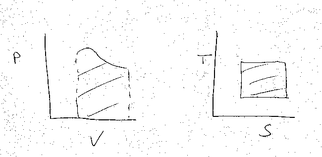

Energy as shown by indicator diagrams. These are graphs connection two (a pair) of variables.
It was realized that the area under a pressure - volume (PV) graph represented work or energy.
Clausius introduced Entropy to pair with temperature to be able to draw a similar graph for heat energy. Again the area under the entropy - temperature (TS) graph gives energy.
The hatched areas in the attachment both represent energy of some sort.
Similar indicator diagrams can be drawn for other pairs of quantities

Studiot said:
The first law is indeed a statement of the principle of conservation of energy. All forms of energy.
So your equations are only part of the story as there are many more forms of energy. Obviously if all our action takes place on a table top we don't need to consider gravitational energy. Similarly if no electric current is flowing we don't need to consider electric energy. and so forth.
With regard to the thermodynamic quantities you mention here is a simple non rigorous answer.
