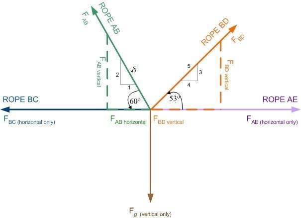

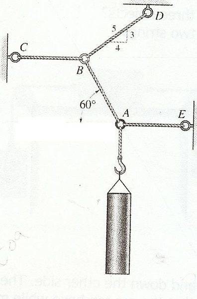

An object of mass 50 kg is supported at point A by five ropes as showin in the figure, and is in equilibrium. Determine the force in each rope.
Figure is attached.
Attempt at solution:
FBD is attached.
If the sides of the triangle formed by ROPE BD are in the relation of 5:3:4 respectively, the angle will be 53o.
Gravitational force Fg = (50kg)(9.8m.s-2) South
= 490N South
The net horizontal and net vertical forces will equal zero as the system is not moving either right or left, or up or down (system is in equilibrium).
Therefore the sum of the horizontal forces pulling West will equal the sum of the horizontal forces pulling East:
FBC horizontal + FAB horizontal = FAE horizontal + FBD horizontal
The vertical force provided by the ropes will equal 490N North to balance the gravitational force exactly.
Therefore the sum of the vertical forces of the ropes will equal 490N:
FAB vertical + FBD vertical = 490N North
And that is as far as I got. Even colour coding the FBD diagram wouldn't help! Please could someone point me in the right direction. Something tells me that I have to put the vertical forces into some relation to one another to calculate how much each contribute to the 490N? Or not? Thank you for any help.

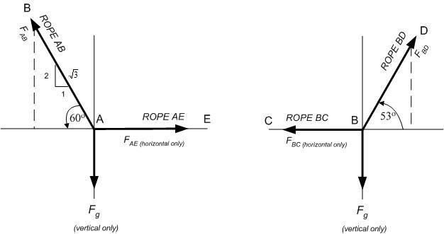

Do this: Draw a FBD for point A and see what you can deduce. Then do the same for point B.
Thanks Doc Al, so much appreciated. So, in essence, I treat it as two separate objects both in equilibrium in their own environments? Makes things simpler! I'm just not sure what the force is that is pulling point B - is it the gravitational force, or AB? I assumed gravitational force?
I attach my FBDs and here is my solution now (suspect there are still some things wrong though - looks a bit odd):
Point A:
FAB vertical = 490N North (equilibrium, gravity)
FAB horizontal = 1/2 (490) West (special right triangle 60o-30o-90o)
= 245N West
sin60o = 490N North / FAB
Therefore FAB = 566N 30o North West
FAE = - FAB horizontal (equilibrium)
Therefore FAE = 245N East
Point B:
FBD vertical = 490N North (equilibrium, gravity)
tan53o = 490N/FBD horizontal (special right triangle 3-4-5)
Therefore FBD horizontal = 369N North
sin53o = 490N/FBD
Therefore FBD = 614N 37o North East
FBC = - FBD horizontal (equilibrium)
Therefore FBC = 369N West
Sure does.
I don't understand this comment. The forces acting on point B are the tensions in the three ropes attached to point B.
Your FBD for point A looks good.
Regarding your FBD for point B:
- FBC is correct
- FBD is at the wrong angle
- Fg does not act on B! It's rope AB that attaches to B, so FAB acts.
Redo that one.
Point A:
= 245N West
This looks OK. A few comments:
They want the tensions in the ropes, which are just the magnitudes of the forces they exert. The directions, of course, are along the ropes. So, for example, let FAB be the tension in rope AB. No need to specify direction when giving your answers.
I'd set it up like this, so that it's easy to see what you're doing:
ΣFx = 0
FAE - FAB cos(60) = 0
FAB cos(60) = FAE
ΣFy = 0
FAB sin(60) - Fg = 0
FAB sin(60) = Fg
Careful about rounding off your calculations. I'd only round off at the last step.
