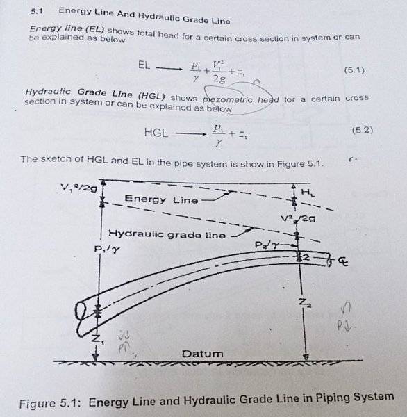

the energy level drop from point 1 to 2 , does it mean that the water flow from point 1 to 2 ?
Yes. The EL has a gradient because of losses, so the flow must be from the higher EL to the lower EL.
