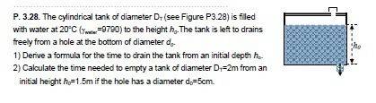

For the problem attached, I solved it and found the answer for part b : 80.21 s
How to get sure or know if the answer is right or not.
Thanks
