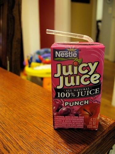

Can someone show me how to model, mathematically, what happens if you place a drink box with a straw sticking out of it, in a vacuum chamber and apply a vacuum?
  • Photo of a pink Nestle Juicy Juice 100% Juice Punch carton, 4.23 fl oz (125 mL), with a clear plastic straw inserted, standing on a wooden table.
Are you saying that the place that the straw passes through the juice box is sealed? Are you assuming that the juice box is rigid? Are you saying that there was air in the top of the juice box when the box was suddenly exposed to the vacuum?

Yes, the juice box is sealed around the straw, but the juice box is not rigid. There is no air in the juice box when exposed to vacuum.
I'm interested in determining whether ambient pressure changes would affect flow from an IV bag. The IV bag gets pressurized by gravity (in my example) and then might be brought onto an airplane, for example.
So you have a balloon full of water sitting on a table, and the balloon is full and open at the neck at the top. You suddenly drop the air pressure in the room. You are interested in what happens as a result, correct?
