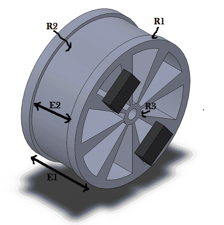

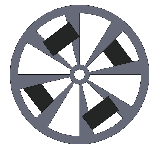

Hi,
I couldn't find how to calculate this flywheel inertia , any help please?! I know that I=1/2(mass*radius²) but it seams more complex then that!

To find the Inertia of this flywheel model it in 3D CAD software (I think you have already done)where from you get easily what you want ie Inertia

Well now, that depends on exactly what the Emna means to do. If you only need 5kW for a short time, you can use the 1kW to spin up the flywheel, then turn on the generator only when you need the burst of power. You can certainly get more power out than you put in; just not continuously.
I=1/2(mass*radius²) is correct for a point mass or ring. For a 3D solid object, you can think of it as being built out of a bunch of point masses. Sum or integrate over each point that makes up the object.
##I = \frac{1}{2} \int \rho r^2 dV## where ##\rho## is the density (as a function of position).

That equation only works for a solid, uniform wheel. For a more complicated shape you may be able to take it in simple pieces and calculate the moment of initial of them individually.

well I'm going to recycle a flywheel of a bicycle, it's made of some kind of plastic an add it some mass like it shown on the picture, i don't know how to find the density of the existed flywheel!

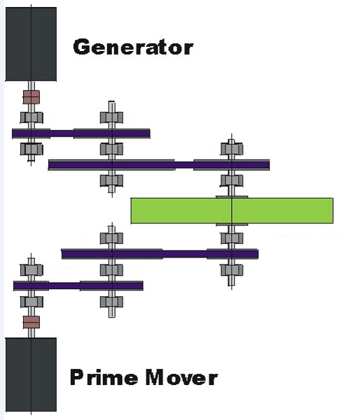

the motor has an angular speed of 1500rpm and 1kw power, the belt pulley will make the generator turn 4 times the motor and the flywheel is supposed to increase the torque as much as you add it mass. i need to study the system to make the generator provides 4kw of power

Is the 4kW just for a short burst? You haven't said anything about that, which makes me worried that you are ignoring the results you don't like.

as long as the system is plugged in it must provide 4kw , if the flywheel helps stocking enough energy for at least 15min so the motor be shut down for that long it would be better.
15 minutes of 4kW is a LOT of energy. I think you need to reconsider the feasibility of the project. There's no way a bicycle wheel will store that.

the belt pulley will do all the work , and it's ok if the flywheel don't stock that energy , it at least ill smooth the energy variation , all i need id how to calculate it's inertia while it has a complicated shape and i got that i should calculate each part of it alone , there's no other way.
You have to mentally break your complex object into simpler objects and then sum the moment of inertia of the simpler objects together.

You have a 1kw motor putting energy into the system. You want to be able to get 4kw out of the system for 15 minutes at a time. And you do not need anything to store energy.
That does not makes sense. You are ignoring the part that is impossible and concentrating on the easy parts that you merely do not know how to do.

This being along the lines of an experimental investigation, perhaps a better approach might be to construct something and then measure its inertia. Just for testing, it needn't be robust since you don't need to spin it fast for this measurement.
Once you know its inertia, you can do some calculations to determine just how much energy it will store at your proposed revs/min. This will show whether your idea is going to be feasible.

You need store 3600KJ energy in the flywheel to 4KW power for 15 min
Presume the 1Kw motor spinning the flywheel at 1700rpm, then Inertia of the wheel will be 0.12kgm2.

In order for the flywheel and generator to deliver 4kW for 15min, the 1kW motor will have to run for at least 60min.

To deliver 4kW for 15min the flywheel will have to store a large amount of energy. I very much doubt that the plastic bicycle wheel mentioned earlier will be strong enough. Risk of explosive failure.

From #16 : This is the picture that describes the proposed system :
The picture shows a continuous action power multiplying system . Supposedly 1 KW in gives 4 KW out .
