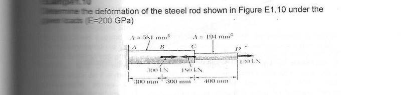

Force acting on steel rod (deformation)
9 replies · 3K views · last reply
foo9008
676

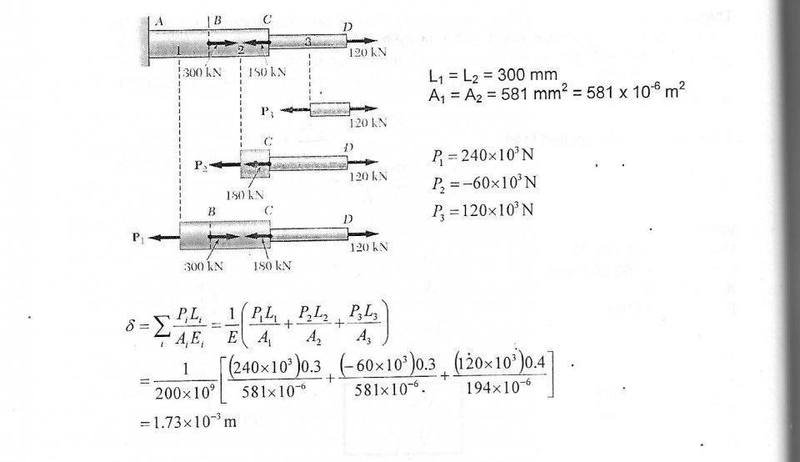

in this problem , i could only understand that P3 = 120KN , i can't understand why P2= -60kN and why P1 = 240kN ? can someone explain ?
  • Diagram of a stepped steel rod fixed at A with points A, B, C, D; segment areas 581 mm² and 194 mm²; loads 300 kN and 150 kN shown, with 150 kN pointing right at D; lengths 300 mm, 300 mm and 400 mm.

  • Free-body diagrams of a stepped bar fixed at A with axial loads 300 kN, 150 kN and 120 kN at points B, C and D, with internal forces P1 = 240x10^3 N, P2 = -60x10^3 N and P3 = 120x10^3 N, and the deflection sum formula evaluated to 1.73x10^-3 m.

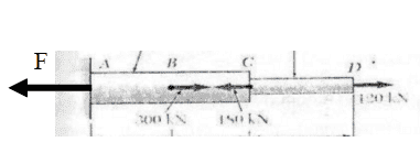

Chestermiller said:
If you do a force balance on the entire rod, what do you get for the reaction force on the left end?
how to do it ? i know only the P3 ... which is 120kN , how to do for P1 and P2 ?

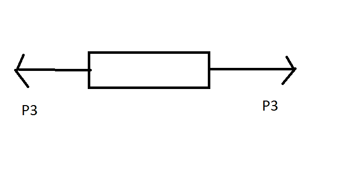

  • Free-body diagram of a rod segment shown as a rectangle with arrows pointing outward at both ends, each labelled P3. The labels are placed below the left and right arrows.

You have 3 forces acting on the rod: 300 kN, 180 kN, and 120 kN. In order of the rod to be in static equilibrium, there must also be a force applied by the wall on the bar at location A. What does that force have to be?

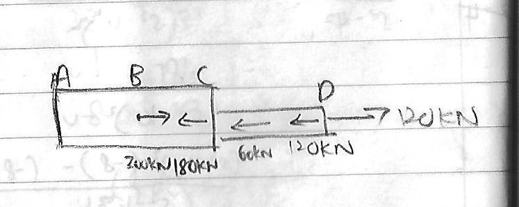

what i found is this ? how to find the force applied by the wall on the bar at location A. ??
btw , i am not sure which 1 is P3 and which one is P2
  • Hand-drawn sketch of a stepped bar fixed at left end A, with points B, C and D marked; arrows show loads of 200kN and 180kN at BC, 60kN and 120kN at CD, and 120kN pulling right at D.

Forget about P1, P2, and P3 for now. Are you saying that you don't know how to do a 1 dimensional equilibrium force balance on a solid object?

yes
