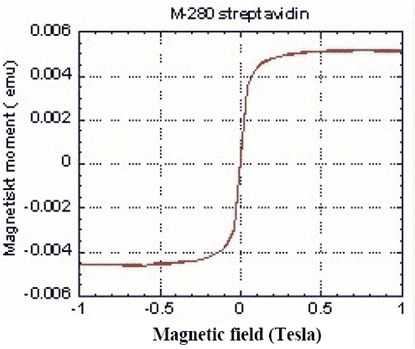

I'm currently doing the project and need to estimate the force that will act on the micron size superparamagnetic particle in the field of permanent magnet.
I found several article there similar problem is solved, but I a bit confused. I hope someone could hep me.
So, the main equation to start with is:
F = ∇(m⋅B),
where B the magnetic field and m - is the magnetic moment, which is also function of B (m = ƒ(B)).
If I have data how magnetic moment (or magnetization) depends on field, like this one:
could I just use m as a constant for the given B? I so the equation terns to be:
F = m(∇⋅B).
Is it correct?
So next I need to to find ∇⋅B, which is as I understood is gradient of B (i.e. dBx/dx+dBy/dy+dBz/dz). Is it right? I have some doubts because in one article they use ∂Bx/dy term. I just thought that this difference may be due to difference in used magnets (permanent vs electromagnet).
And the last question is that would be direction of force vector? Anti-parallel to field?

The expression is ##\vec F=-\vec{\nabla}(\vec{m}\cdot \vec{B}).## I would use the vector identity ##\vec{\nabla}(\vec{A}\cdot \vec {B})=\vec{A}\times(\vec{\nabla}\times \vec{B})+\vec{B}\times(\vec{\nabla}\times \vec{A})+(\vec{A} \cdot \vec{\nabla} ) \vec{B}+(\vec{B} \cdot \vec{\nabla} ) \vec{A}.##
Note that the third term can be expanded as $$(\vec{A} \cdot \vec{\nabla} ) \vec{B}=\left( A_x\frac{\partial}{\partial x} +A_y\frac{\partial}{\partial y} +A_z\frac{\partial}{\partial z} \right)(B_x \hat x+B_y \hat y +B_z \hat z) $$ and similarly for the fourth term. It looks scary, but a lot of terms vanish. Yes, you can use m as a constant because although it depends on the external magnetic field, its spatial derivatives vanish. Eventually, you will get terms like the one described in the article. Which field derivatives you should use depend on the shape of the pole faces. Usually, there is a dominant derivative while the others may approximately be set to zero. The shape of the pole faces determines the gradient components which in turn determine the direction of the force.

...I'm don't know that "magnetic moment is going to be a constant" is actually means ...
It means that it has fixed direction and magnitude. Look at the graph you posted. If you define as ##z## the direction of the magnetic field at the location where your sample is, then your graph says that as long as the magnitude of the magnetic field is greater than about 0.3 T, the magnetic moment points in the same direction as the field and has magnitude about 0.005 emu.
If you use a strong enough disc magnet of cylindrical symmetry and you place your sample on the z-axis, then you can approximate ##\vec{m}\approx m \hat z## and the field ##\vec{B}\approx B(z) \hat z##. So the force becomes ##\vec{F} \approx m \frac{\partial B_z}{\partial z} \hat z##. Needless to say, if you plan to take your own measurements, you must calibrate your method by measuring the force on a standard sample.
Please clarify, if magnetic field is less then 0.3 T the magnetic moment still point at the same direction (parallel to field) and only magnitude is changing?
Thanks in advance!
Yes, that's what the graph that you posted is saying.

Oleg said:
Great! But how did you understand that?
I looked at the graph that you posted. It shows that when the magnetic field (horizontal axis) is negative, the magnetic moment (vertical axis) is also negative. When the magnetic field is positive, the magnetic moment is also positive. When the field is zero, the magnetic moment is zero. All this says to me that the magnetic moment follows the magnetic field like a compass needle more or less. Actually the moment that is plotted in the graph is the sum of many moments some of which may be at an angle with respect to magnetic field. The reason that they are not all lined at values lower than about 0.3 T is because of thermal fluctuations. However, at fields greater than about 0.5 T the magnetic energy overwhelms the thermal energy and the "magnetic needles" are all pulled in the direction of the field and the total magnetic moment of the sample saturates.
