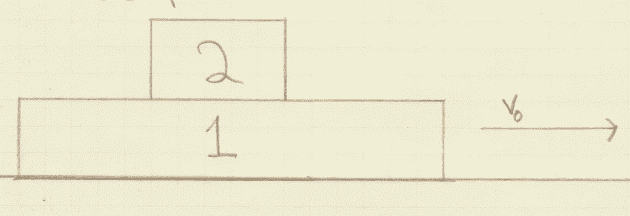

A small box (mass m1) is placed upon a large box (mass m2); the large box i placed on a horizontal table. The boxes begin a rest on the table. The lower box is hit by a horizontal blow at the time t=0 resulting in a initial velocity v0. The frictioncoefficient between all surfaces are µk
a) Draw force-diagrams for both boxes as the move relative to each other. Indicate all Newtons-Third-Law-Pairs.
b) Determine all velocities and accelerations of the boxes as the move relative to each other. At what time T do the boxes not move relative to each other anymore?
c) Determine the acceleration of the boxes when they do not move relative to each other. What length L do the boxes move in this fase? The initial velocity can be concidered know as v1

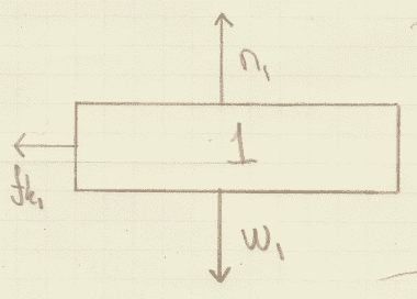

I started drawing the force diagrams. No problem there. It was easy to see that the normal force in both cases were pairing up with the gravitational force.

Picture of scenario:

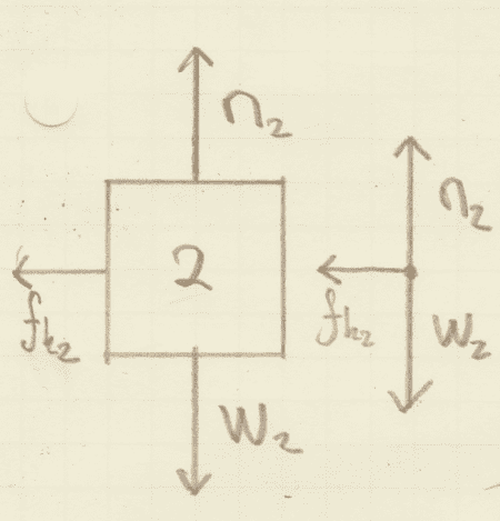

Force Diagrams:
What are fk1 and fk2? The friction forces need more thought here.

If you call it box 1, why do you say "second box"? Its acceleration is wrong because you are missing a force acting on it.
For the box on top, be careful with the sign. In which direction will it accelerate?
Careful: The normal force and the gravitational force are not 3rd-law pairs.
Oh, yeah! That's right! They are just equal and opposite...

What are fk1 and fk2? The friction forces need more thought here.If you call it box 1, why do you say "second box"? Its acceleration is wrong because you are missing a force acting on it.
Do you mean that box 2 has a velocity of 0 at t=0 and it therefore because of the friction will accelerate in the same direction as the velocity of box 1?
I understand that it is a bit confusing when referred to as both box 1 and 'second box' but they are the same
fk1 and fk2 should be the same - I realize that now
For example, yes.
They are not, no matter what they represent (which is still undefined).
