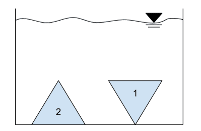

Two identical triangles are placed inside a water tank as shown in the diagram below. The triangles are fixed in position. On which triangle will a greater force be exerted?
Equal on both.
Cannot say
The question is part of a mechanical aptitude test. The correct answer is 2, but there is no explanation.
I do not understand why is 2, and not "equal on both". Can anyone give me some clues?.
The only way that can see is to not allow liquid access on (2) body base.

The author of the question deserves a big FAIL. It could be another one of those copy and paste with parts left out and thus becomes ambigious, or non-sensical.
Anyways,do you know anything about hydrostatic forces, bouyancy, pressure? which is probably waht the question was supposed to get at.
What is your reasoning, or calculations, that the answer should "be equal"?

I have a scant knowledge of hydrostatics, to say the least.
My answer is just a guess, given that they are identical triangles and they are at the same depth. The only difference is their position, but the basic formulas of pressure and force do not consider the position:
p=dgh
F=PA
Am I wrong?, what else should I consider?.

Perhaps the best (most interesting, most educational) question to ask is: What is the force exerted by the bottom of the pool on the triangle? It's different for the two triangles, and when you can see why you'll have nailed this class of problems.
Likes Ikastun and rootone
Are they? The centroid of a triangle is 1/3rd of the way up from the base. So isn't 2 slightly deeper than 1 ?

It's not clear which force the question is asking for. The net force on the triangle? The hydrostatic force on the triangles? Or the force exerted by the bottom the container on the triangles?
I think the hydrostatic force is being implied. Secondly, the question does not ask for a numerical answer - there is no need to know the 3rd spatial dimension features of the triangles or the pool to answer this question. No offense to anyone, but I think the question is obviously talking about prisms of equal depth into the page (so one only needs to concentrate upon the 2 dimensional view), since the answer cannot otherwise be determined with the given information (unless there were some omissions while posting the question).

My objection is that the author seems to not have considered the following simple analysis:
Since the triangles are fixed in position, there is no acceleration, and according to Fnet = ma, with acceleration a being 0, the net force Fnet = 0.
In which case, " On which triangle will a greater force be exerted?" has the answer "equal on both".

Agree the question is worded too vaguely. But I think the intent of the question is hydrostatic forces. Although as correctly pointed out, the net force must be 0 since acc = 0. The magnitude of the hydrostatic forces on the individual faces is relevant. The question could have been worded, as you fill the container with more and more water, which triangle will crush first? The answer would certainly be 2. The centroid of the 2 triangle is lower than 1's, thus 2's hydrostatic pressure will be greater. One thought experiment you can do is imagine the tank is only filled to a depth just equal to the height of the triangles. Triangle 1 would have virtually no force on one entire sides. While triangle 2 would have no force only at a vertex.

My interpretation is that the question asks for a comparison of the sum of the magnitudes of the forces on the three sides on each triangle.
Since it is rarely meaningful to add the magnitudes of forces while ignoring their directions, the question seems a poor one.
OK its not a perfectly worded question, but:
  1. this is a mechanical aptitude test, and to my mind making sense of imperfect information is a relevant part of assessing mechanical aptitude;
  2. the question states that the "triangles" are identical, so their 3rd dimension is irrelevant - in fact you can even assume they ARE triangles with zero thickness;
  3. one possible answer is "the net force on each triangle is zero because they are fixed in position", but that is not the best answer because it doesn't make use of all the information provided in the question; a better answer is "the force of water pressure on triangle 2 is greater because the mean depth of its surface area is greater".

If it's not sealed to the bottom, the buoyant forces are clearly equal. As is the weight of the triangles and the force required to fix them in place. No reasonable vector sum fits the "correct" answer.
If it is sealed to the bottom, one can still find a state of affairs where both triangles have zero net force. So that still fails to produce the "correct" answer.

Why are you ignoring the magnitude of the force on the faces of the triangles? If they are triangles (with zero thickness) the force on the sides is zero.
Reaching back to the problem definition to rationalize an answer... Because the triangles are "fixed in place". If the triangles are of zero thickness and we are looking at pressure on their faces, that specification is pointless.

If prism no 2 is sealed at the bottom, the "hydrostatic force" is larger on it, as in the proposed answer. It is not really buoyant force, as it points downwards.
On prism 1 we have the two equal forces on the sides, 2Fs (up) minus the force on the flat top Ff (down).
For the prism 2 we just have 2Fs (down). 2Fs> (2Fs-Ff)

Although the net buoyant forces are equal, the magnitude of the forces on the individual faces are different. If you had one scuba diver 10 feet down and another 100 feet down, their net buoyant forces are equal as they are both neutrally buoyant, but we would say the deeper diver has more force on him as the pressure all around him is greater. Another example would be if, instead of triangles under water, you had 2 weight lifters, one lifting a 10 lbs barbell above his head and another lifting a 100 lbs barbell. Which lifter has more force on him? Would anyone honestly answer they are both equal to 0, because they are not accelerating? In practical terms, when we speak of forces on things, we are concerned with stresses and strains. (Can you guess I'm an ME?) For every statics problem in the world, the net force is 0, but the load on the object creating stress is non-zero.

-- because 2's center of gravity is deeper than 1's center of gravity

Look at the very bottom of the tank (say it is 10 meters in depth) ... that is the highest pressure. And the upside down triangle has a single point at that depth, while the rightside up triangle has an entire side at that pressure. The upside down triangle has an entire side at the lowest submersion, while the rightside up has a single point.
It is intuitive to think they are the same. The same shapes at the same depths. But the orientation actually puts one as deeper than the other, due to the center of cross sectional area. And due to the distribution of the asymmetry along the depth, there is difference in cumulative pressure.
