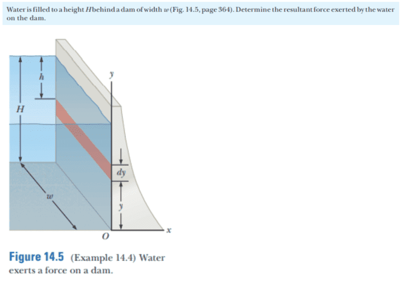

Hi!
For this fluid statics problem,

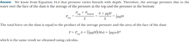

One of the answers is:
However, why did they assume the pressure at the top was zero? I thought the pressure at the top would be 1 atm?

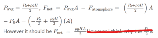

So tried to take atmospheric pressure into account putting 1 atm at the top,
Do you please know how to get P_0A/2 so that the P_0A/2 terms can cancel to get their hydrostatic force? I assume that the atmospheric pressure is the same at the top and bottom since the height of the dam is negligible to the scale of the atmosphere.
That one atmosphere is present above the water, through the water column, and also against the dry face of the dam wall. Those two atmospheric forces on the two sides of the dam wall oppose each other, and so can be cancelled.

How did you calculate Pavg?
But the problem does not ask for the total net force on the dam. It asks for the resultant force exerted by the water on the dam. While the problem author likely intended to ask for the total net force, it is not what they wrote.
Thanks for your reply. I found P_avg by assuming the pressure at the top was 1 atm, and the pressure at the bottom was pgH then took the average (divided by 2). Many thanks,
Thanks, yes, I agree. I just wanted to solve the problem by taking the atmosphere into account then cancelling with Newton's Second Law.
Is it though?
Orodruin said:
Is it though?
Thanks for your reply, yeah true the pressure is p_0 + pgH which solves my confusion. Thank you very much for pointing that out!
Ok thank you for pointing that out!
