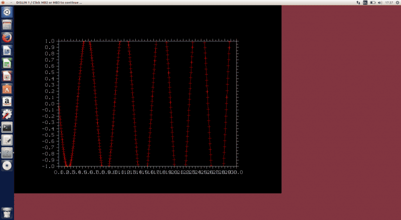

Anyhow, I have implemented the advice and it has definitely gotten me a lot further than before. I am still focusing on simple euler, but I have a couple of clear problems still.
The outputted data, and consequently the graph of v vs. t (as well as with x) is not the same upon each run. And on ANY of the runs, I am not observing anything remotely like simple harmonic motion.
I'll put here the revised code and let you take another look (sorry I have to type it all out as can't copy and paste over from virtual machine).
Also, if you could tell me how to simply put both the velocity and position curves on a single graph that would be helpful for future reference.
PROGRAM eulershm
USE DISLIN
IMPLICIT NONE
INTEGER, PARAMETER ::
n = 600
INTEGER:: i
REAL, DIMENSION (n) :: x, v, t
x(i) = 1 !Initialization
v(i) = 0
t(i) = 0
DO i = 1,n
CALL evalS(v(i), v(i+1), x(i), x(i+1), t(i), t(i+1))
PRINT*, "v(",i,")=", v(i) !Print out values of v (for clarification)
END DO
CALL
METAFL('XWIN')
CALL DISINI()
CALL GRAF(0.,30.,0.,1.,-1.,1.,-1.,0.1)
CALL COLOR('RED')
CALL CURVE(t,v,i)
DO i = 1,n
CALL RLSYMB 93, t(i), v(i))
END DO
END PROGRAM eulershm
SUBROUTINE evalS(v1, v2, x1, x2, t1, t2)
IMPLICIT NONE
REAL, INTENT(IN)::v1,x1,t1
REAL, INTENT(OUT)::v2, x2, t2
REAL, PARAMETER:: w = 1, dt = 0.05
v2 = v1 - ((w**2)*x1)*dt
x2 = x1 + v1*dt
t2 = t1 + dt
END SUBROUTINE evalS

Thanks Mark
1) I had previously declared i = 1, but removed this and forgot to change my initialisation.
2) This is the thing that has caught me out now numerous times. Should I set then the array size (n) as 601, and then run from i = 1 to (n-1)?
3) Thats a mistake from re-typing it all out, sorry!
Having made these changes, finally obtained a function close to simple harmonic oscillation that increases in amplitude over time (as consequential error of the program).
I have uploaded a screenshot so you can admire your great contributions!
