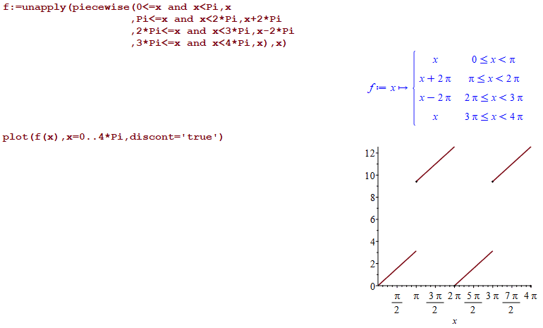

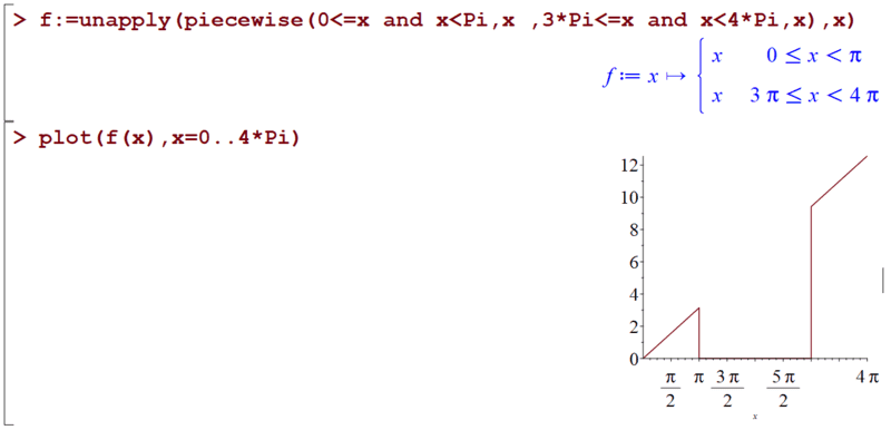

Maple session defining f as the piecewise function x for 0 ≤ x < π and x for 3π ≤ x < 4π, with its plot over 0 to 4π: a rising segment from 0 to π, zero from π to 3π, then a rising segment from 3π to 4π.
This isn't really the problem, but I have a feeling my problem the assignments, is me misunderstanding the function description. I don't see how this 2 pi periodic, but I also do not understand how else to interpret it.

  • Maple session defining f as the piecewise function x for 0 ≤ x < π and x for 3π ≤ x < 4π, with its plot over 0 to 4π: a rising segment from 0 to π, zero from π to 3π, then a rising segment from 3π to 4π.
So it's ##4\pi## periodic, a simple typo. What comes after your snippet ?
I should have mentioned that it is dealing with Fourier series, so it HAS to be ##2*\pi## periodic. Is it correct to assume, that I then have to make it that way. That is fill in the span between ##(\pi,3*\pi)## in such a way as to make the fuction into a ##2*\pi## function?

Doing that wouldn't fit with the last part of the interval. As for the other assignments:
Printed question: ii) Is f continuous? If not, find all the points where f is discontinuous.
This is easily shown using a Theorem in my book, and the points seem to be ##n*\pi, n = 1,2,3..## Now ofc this is only right if my assumption about function is correct (not the one I have written above), which is:
Maple plot of a sawtooth-like function on 0 to 4pi with jumps at pi, 2pi and 3pi; a piecewise definition for f(x) is shown beside it, with f(x)=x on [0,pi), x+2pi on [pi,2pi), x-2pi on [2pi,3pi) and x on [3pi,4pi).
However this is what I aren't sure about, but its the only option that I can think of, which also satisfies the next assignment

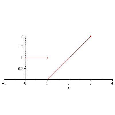

Well, one thing I learned from this thread was the discont = 'true' option in Maple when plotting piecewise continuous functions to get nice plots including correct end points:
> restart: with(plots):
> f := piecewise(0 <= x and x <= 1, 1, x > 1 and x <= 3, x-1);
> plot(f, x = -1 .. 4, discont = 'true', scaling = constrained);
Plot of a piecewise function on x from -1 to 4 and y from 0 to 2: a horizontal segment at y = 1 for 0 to 1, then a line rising from (1, 0) to (3, 2), with open and closed endpoint markers.
Complete with the dots in the right places. Thanks to @NicolaiTheDane

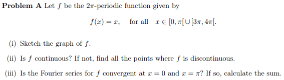

As per your asking for what comes after BvU. I do not want to be rude, but I have already shown you all there is. I even say "as for the other assignments" in post #5. I left out assignment (i), because its merely asking me to sketch the graph, but that is it. For convenience I'll show it all in one snip.
Printed problem statement: Problem A. Let f be the 2π-periodic function given by f(x) = x for all x in [0, π[ ∪ [3π, 4π[. Parts (i) sketch the graph of f, (ii) is f continuous, and (iii) is the Fourier series convergent at x = 0 and x = π.
No offence taken; thanks. You even provide the solution -- which is great: it can sometimes unveil what was intended.
From that solution I favour the picture in #5 over that in #1: it satisfies the answers (both of them)!
How the intended function follows from ## f(x) = x \quad\forall \ x\in [0,\pi[ \; \cup \; [3\pi, 4\pi [ \ \ ## is a mystery to me. Perhaps something to do with the left "[" instead of the right "]", but I doubt it.
That function description, when interpreted as in #1 falls short anyway: it doesn't tell you what the function value is for ##x\in [\pi,\;3\pi]## and you have to assume something (like 0 as you did).
Assuming 0, the exercise can still be done, but the answers come out different ( I think :rolleyes: ):
(ii) ##n\pi\cup (2n+1)\pi##
(iii) ##2\pi## and ##\pi/2##
