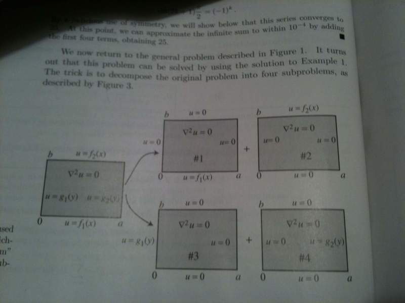

My question involves the mid-point in deriving some of the equations to solve Laplace's equation in rectangular coordinates. The question may no make sense as it isn't problem specific. I can provide boundary values if necessary - just let me know.
I've included a photo of how the example problem is broken up. For my question we'll choose subproblem #1.
[tex]u(x,y)=\sum^{\infty}_{n=1} A_{n} sin \frac{n \pi x}{a}sinh\frac{n\pi(b-y)}{a}[/tex]
[tex]A_{n}= \frac{2}{a sinh \frac{n \pi b}{a}} \int^{a}_{0} f(x) sin \frac{n \pi x}{a} dx[/tex]
I don't understand how I get from the summation to the integral so I can solve for An. I see the pattern and transform the four summations in the example, but I'd really like to know the how/why it's done.
Let me know if I need to include anymore information as I don't have much regarding the actual problem. :smile:
  • Diagram of a rectangle with sides a and b decomposed into four subproblems #1 to #4, each a rectangle with Laplace equation and different boundary conditions, summing to the original problem.
The non-zero boundary condition is
[tex]f(x) = u(x,0) = \sum^{\infty}_{m=1} \left(A_m\sinh\frac{m\pi b}{a}\right) \sin \frac{m \pi x}{a}[/tex]
which is a Fourier series where the quantity in the parentheses is the m-th coefficient. Do you know how solve for the coefficients of a Fourier series?

Suppose you have
[tex]f(x) = \sum_{m=1}^\infty b_m \sin \frac{m\pi x}{L}[/tex]
Multiply both sides by sin (nπx/L) and integrate from 0 to L. Use the fact that
[tex]\int_0^L \sin \frac{m\pi x}{L}\sin \frac{n\pi x}{L}\,dx = \frac{L}{2}\delta_{mn}[/tex]
where δmn is the Kronecker delta.
