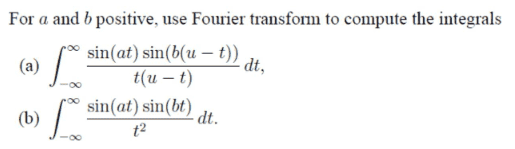

Hello again. Having some issues on Fourier transform. Can someone please tell me how to proceed? Need to solve this then use some software to check my answer but how to solve for a and b. Plzz help

Hint for (a): the integral has the form of a convolution $g(u) \star h(u)$. So we can apply the convolution theorem, evaluate $G(f)\cdot H(f)$, and take its inverse Fourier transform.
We can pick for instance $g(u)=\frac{\sin(au)}{au}$ and $h(u)=\frac{\sin(bu)}{bu}$. And look up their Fourier transforms in a table.

The convolution $(g\star h)(x)$ is defined as:
$$(g\star h)(x) = \int_{-\infty}^\infty g(t)h(x-t)\,dt$$
And according to the convolution theorem we have:
$$\mathscr F_x\{(g\star h)(x)\}(f)=G(f)H(f)$$
where $G(f)$ is the Fourier transform of $g(x)$, $H(f)$ is the Fourier transform of $h(x)$, and $\mathscr F_x$ is the Fourier transform with respect to the variable $x$.
Put otherwise, we have:
$$(g\star h)(x) = \mathscr F_f^{-1}\{G(f)H(f)\}(x) \tag 1$$
where $\mathscr F_f^{-1}$ is the inverse Fourier transform with respect to the variable $f$
Now let's define $g(x)=\frac{\sin(ax)}{ax}$ and $h(x)=\frac{\sin(bx)}{bx}$.
Then:
$$\int_{-\infty} \frac{\sin(at)\sin(b(u-t))}{t(u-t)}\,dt = ab \int_{-\infty} \frac{\sin(at)}{at}\cdot\frac{\sin(b(u-t))}{b(u-t)}\,dt = ab \int_{-\infty} g(t)h(u-t)\,dt =ab\cdot (g \star h)(u)
= ab\cdot \mathscr F_f^{-1}\{G(f)H(f)\}(u) \tag 2$$
Before we go any further, can you clarify which version of the Fourier transform you have?
That's because there are many different versions around, and they result in different transformations with different variables.
You should have a definition like:
$$\mathscr F_x\{f(x)\}(f) \overset{\text{def}}= \int_{-\infty}^\infty f(x)e^{2\pi i f x}\,dx$$
Can you quote the definition that you have that is probably slightly different?
Additionally, we need the Fourier transform of $\frac{\sin{x}}{x}$ or something similar.
Do you have a table of Fourier transforms where you can look it up?
If so, what is the transform you have?

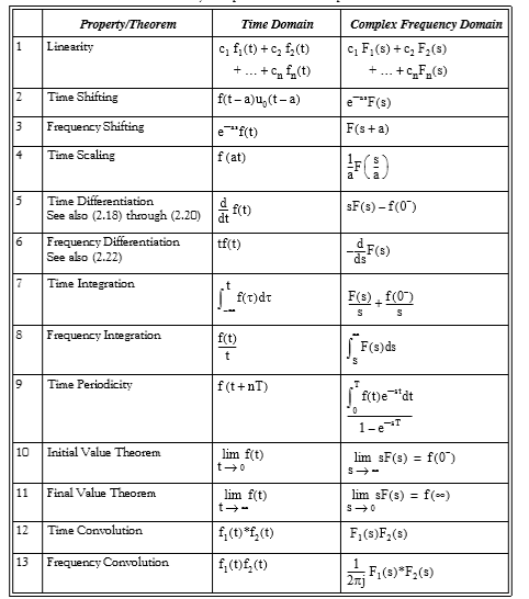

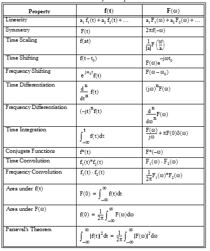

Thnks a lot. as for the Fourier transform table i only have these 2 that my former lecturer left me. As for the definition, can't find any... can any definition be used as I will need to input on Matlab to see if the results corresponds?
You seem to be missing the actual definition, and you're also missing a table of transforms of common functions.
Anyway, we can refer to the Tables of important Fourier transforms on wiki.
Let's pick the version that transforms $f(x)$ to $\hat f(\nu)$ in those tables.
I expect that is the version that your tables refer to, although it refers to the variable $\nu$ instead of $\omega$.
If you want, you can also refer to these tables that have the same variable convention that you have.
You'll see that the second table on wiki has:
$$\operatorname{sinc}(ax) \longleftrightarrow \frac 1{|a|}\operatorname{rect}\left(\frac{\nu}{2\pi a}\right)$$
where $\operatorname{sinc}(x)\overset{\text{def}}=\frac{\sin(\pi x)}{\pi x}$, and $\operatorname{rect}(x)\overset{\text{def}}=\begin{cases}1&\text{if }-\frac 12< x <\frac 12\\0&\text{otherwise}\end{cases}$.
Can we find the Fourier transform of $\frac{\sin(bx)}{bx}$ with this information?

we use this formula ab⋅F−1 f {G(f)H(f)}(u) = ab. F-1 f {[π/|a|]*[ π/|b|]} (u)... How?

Let $m$ be the minimum of the positive $a$ and $b$.
Then we can write $G(\omega)H(\omega)=\frac\pi a\frac\pi b \operatorname{rect}\left(\frac\omega{2m}\right)$.
We have the transformation pair $\frac{\sin{mx}}{mx} \longleftrightarrow \frac\pi {|m|}\operatorname{rect}\left(\frac\omega{2m}\right)$.
Therefore $\mathscr F_\omega^{-1}\{G(\omega)H(\omega)\}(u) = \frac\pi a\frac\pi b\frac m\pi \frac{\sin mu}{mu}$.
So the original integral is $ab\cdot\frac\pi a\frac\pi b\frac m\pi \frac{\sin mu}{mu}=\frac{\pi\sin mu}{u}$ where $m=\min(a,b)$.

is this πsinmu/u the answer?
Are there more steps? Need to attend work(will finish at 0500am, won't be able to clarify/answer u if i have any issues concerning the next step if any. Sorry for taking up ur time on a saturday but when it comes to maths well i try i really really try but ...Plzz be online tomorrow to help me again...

Yes. That is the answer for (a). There are no more steps.
As for (b), hint: substitute $u=0$ in the result of (a).
