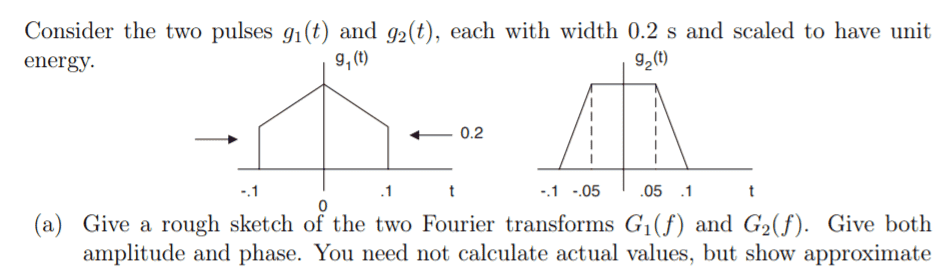

Hi,
In class I have learned how to find the Fourier transform of rectangular pulses. However, how do I solve a problem when I should sketch the Fourier transform of a pulse that isn't exactly rectangular.
For instance "Sketch the Fourier transform of the following 2 pulses"
Thanks in advance, I would have known how to exactly solve the problem if it was rectangular :(

You most likely have learned a few things more - they are required for this exercise:
  1. FT is linear: FT of a sum is sum of FT's and vice versa
  2. FT of a product is a convolution and vice versa
And the exercise consists of recognizing which is which.
Start with convolving two rectangles to see what you get ...

Do you mean that g1 is the convolution of a linear function overlapped with a rectangle pusle? On both the negative and positive axis?
Almost, but: it is not. Did you follow my simple advice ? What do you get when you convolve two rectangles ?
One way to do this could be to look at the derivative two times, and graph the dirac amplitudes, then you get dirac functions as amplitudes (for the second derivative) then you conduct the Fourier of a derivative twice (iw)^2 (on the left hand side) and on the right hand side then you get dirac functions which become e^... Then you divide both sides with (iw)^2 and get the X(w) = ... e^... divided by (iw)^2 which you can graph in your calculator and hence make a sketch.
However that is when you do a Fourier with the variable w right (omega) now we have the Fourier transform in f where f=2*pi*w
Do you understand my concern, or do the way I suggested also work to draw the Fourier (instead of thinking in convolutions)?

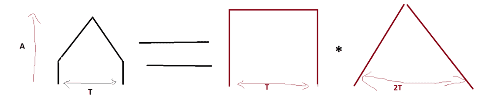

You probably mean that you get a triangle when you convoluted two rectangles? I still don't really understand how this would help me. Can I use the sum of a 1. Rectanle pulse Fourier transformed 2. Triangular pulse? So
F(Rectangle + Rectangle*Rectangle) sort of thing?

Is this correct?
Where the * representens convolution. So the left picture is the convolution of the 2 red graphs?
No, unfortunately not correct. If a plus sign explains g1, then this convolution certainly does not.
Counter-indication: the jump in g1
Work out the right-hand side using the definition of a convolution to prove it for yourself. Not all that complicated and very enlightening.

You have seen that a convolution of two rectangles gives a triangle. Spend a few moment trying to understand why the convolution of a triangle and a rectangle should involve some ##t^2## -- so this does not appear in your exercise.
If that is asking too much, you can have it chewed out for you here (but I really think you should try it for yourself first
Not 'sort of', but spot on !
Bedtime for me so I'll leave you to do g2 on your own. Ask yourself: if I get a triangle from two identical squares, what has to change to get a flat ceiling ?
