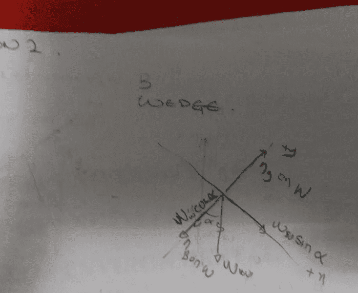

why is the velocity of the wedge not zero in the y direction?i think i may have drawn my free body diagrams incorrectly, which may be the reason that i am not able to get the right answers. i have attached a picture of my free body diagrams
  • Handwritten free-body diagram titled Block, showing a point with arrows for N on B pointing up-right, W_B cos α and W_B sin α components, the weight W_B pointing down, angle α marked, and axes labelled +y and +x.
  • Handwritten free-body diagram labelled 'wedge' showing forces on a block on an inclined surface: arrows for N, mg, mg cos α, mg sin α, and the force of block on wedge, with axes marked +x and +y.

The velocity of the wedge is zero in the vertical direction, which is not the y direction. I also made a mistake in my previous post when I said that the velocity of the block is zero in the y direction. The component of the block velocity relative to the wedge is zero in the y direction normal to the slope. But the wedge is moving in the horizontal direction, and thus has components in the directions parallel and perpendicular to the slope.
It might be easier to set this problem up by doing the balances in the horizontal and vertical directions, rather than in the directions perpendicular and parallel to the incline. Try doing this and see what you get.
I'll look over what you did later today.
Chet
I'm not able to follow your diagrams. Please try to set up the problem with the coordinate axes horizontal and vertical, not perpendicular and parallel to the incline.
Do you understand yet why the wedge velocity is not zero in the direction perpendicular to the incline, and why the normal force by the ground on the wedge is not pointed in the direction perpendicular to the incline?
