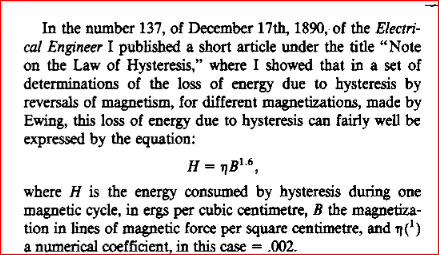

in Steinmetz's own words
Scanned page of printed text quoting Steinmetz's 1890 article on the law of hysteresis, with the equation H = ηB^1.6 where H is hysteresis energy per cycle, B is magnetization, and η is a coefficient equal to .002.
so i don't see why there's a voltage term in your first formula.
his article is posted here
http://garagehacker.com/files/C.P Steinmetz - On the Law of Hysteresis - Pt 1.pdf

In addition, I'm a bit lost on page 199 (page 3 on the site) as to how a power of 1.6 came into it.
That's the curve fit to Steinmetz's empirical data.

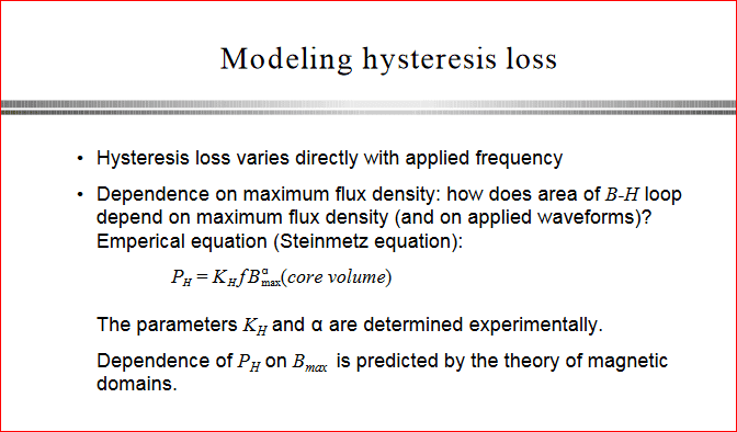

http://ecee.colorado.edu/copec/book/slides/Ch12slide.pdf
Slide titled "Modeling hysteresis loss" with bullets on frequency and maximum flux density dependence, and the Steinmetz equation P_H = K_H f B_max^α (core volume).

A very good reference @jim hardy . I would also like to run across a good reference that explains why some types of iron and other materials make good transformers with minimal hysteresis loss and also don't go into a permanent magnet mode while other materials make good permanent magnets whose permanent magnetism is very difficult to disrupt.

jim hardy said:
Given hysteresis loss = η×Bmax×f
SI units are
Joules = η X Teslas X Hertz
That's incorrect; the unit is
Joules = η X Teslas
as can be seen from the Steinmetz article:
Printed equation H = eta B^1.6 with the following text explaining that H is the energy consumed by hysteresis per magnetic cycle in ergs per cubic centimetre and B the magnetization.
Unrelated, but thank-you for the slideshow, that had everything on eddy currents that I needed.
Joules = η X Teslas
thanks - indeed i included hz so it should be watts not joules
correction is appreciated , i fixed it up above
