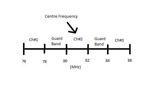

A frequency band from 76 MHz to 86 MHz is available for wireless transmission. Design
a frequency division multiplexing system with 2 MHz wide channels and 2 MHz guard bands
(assume that guard bands aren’t necessary at the lower and upper ends of the band). Indicate
where each channel begins and ends, as well as its centre frequency. How many channels fit
inside the given frequency band?
I think just logic of what the question is asking is enough
See attachment for a diagram I made. I was just unsure if I was doing this correctly or not. If anyone could confirm that would be great.
  • Hand-drawn frequency axis from 76 to 86 MHz with Ch#1 (76-78), guard band (78-80), Ch#2 (80-82, arrow marks centre frequency), guard band (82-84), and Ch#3 (84-86).

Looks right to me.
