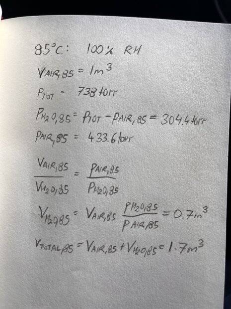

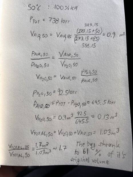

Here are my calculations, what are your thoughts?

I do not have confidence in your 61% volume solution.

Thank you for very much for your detailed answer. Regarding the second approximation, the mass in the bag does remain constant. However, the mass in the gas phase does decrease due to the water condensing. Therefore, I would think that in this case the density ratios cannot be used to calculate the volume ratios. How far off the mark would I be with my reasoning?
(Or perhaps that is what you already pointed out by saying that this ignores the volume of condensate in the bag?)

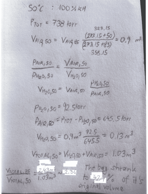

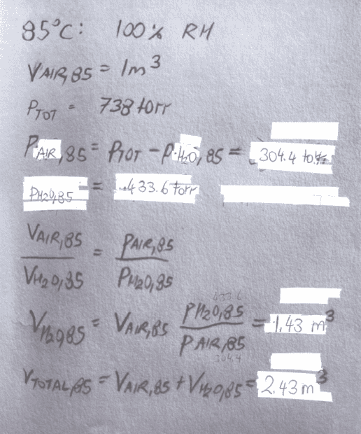

Hello,
Thank you very much for your detailed calculation.
$$V_{85}=\frac{(1)(0.082)(273+85)}{0.9711}=31.2 \ liters$$ seems to contain a small error or typo
$$V_{85}=\frac{(1)(0.082)(273+85)}{0.9711}=30.2 \ liters$$ is the correct number.
So the the volume ratio is 12.9/30.2 =0.43 instead of 0.414

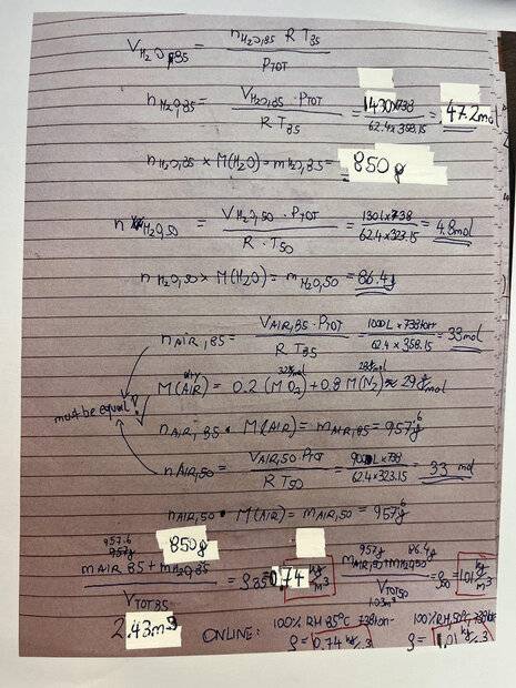

In the attachment, please find my updated calculations which give the same result as yours. I chose to also calculate the moist air densities (like Baluncore's approach) and compared them with the literature to check my calculations. I prefer your approach via the moles which is more elegant than my calculations.

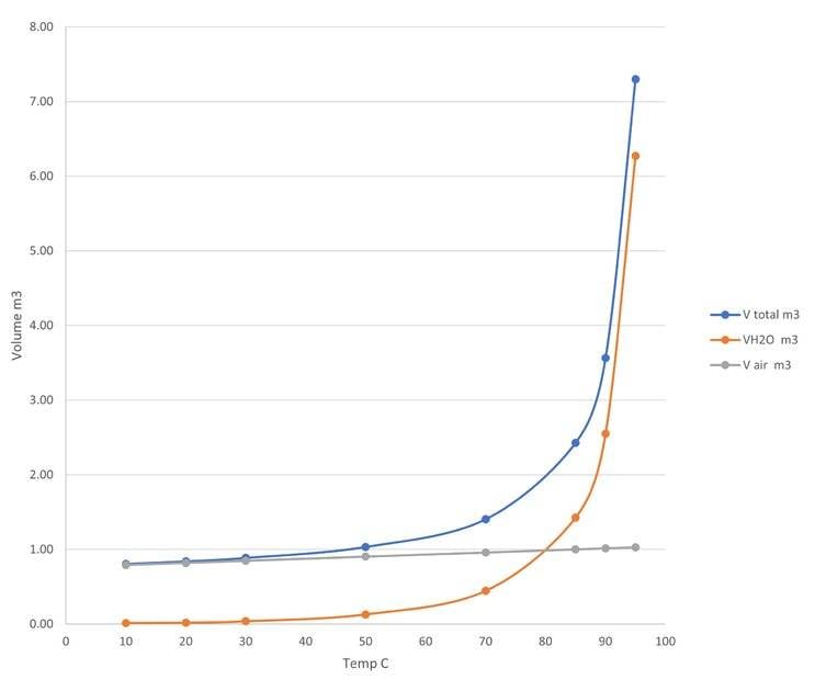

In addition, I attached a graph that shows the partial and final volumes of 100 % RH air as temperature changes.
Thank you everyone for your help. This will allow me to calculate the mass flow changes in a dryer scrubber system at work with confidence:) !
