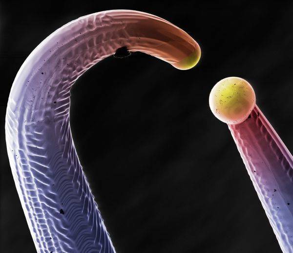

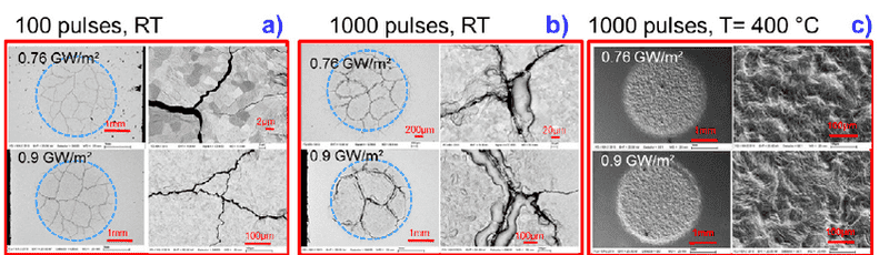

Most of the ON/OFF cold/hot cycle breakage I see from thicker heating Tungsten filaments is from stress induced fractures (mechanical stress as well as thermal stress). Small stress cracks form at a grain boundary increasing the localized resistance at those cracks. As the cracks grow from continued stress events the increased resistance results in a increasing voltage across each non-uniformity, more localized power dissipated at that point creating a hot(er) spots on the filament. Eventually one of the crack/hot spots will fail causing an growing arc that melts the ends of the broken filament. The classic signature of this premature breaking is the ball on the end of a still 'thick' filament. A properly worn filament should have two evenly tapered ends
https://www.researchgate.net/figure/Different-damage-types-observed-after-the-exposure-of-tungsten-to-thermal-shock-events_fig2_261294267

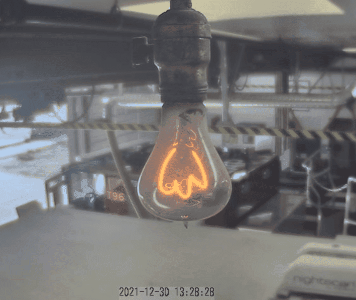

anorlunda said:
The Centennial Light bulb has been lit since 1901. Here's today's screen capture from the live web cam.
This bulb is so old and notorious that I believe the Mayan calendar and the Bible's Book of Revelation have references to it.I do wonder whether the bulb's longevity has to do with the rather low temperature of it's filament compared to more modern bulbs.
