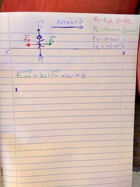

I created this example to see if i can explain how humans walk but I can't. If I'm correct, when we push the ground to move forward we apply a force with the opposite direction (backward). Let's name this force Fp (for push). Because of that force, a friction force is being applied to us with the opposite direction of Fp (forward). While |Fp| <= |Fsmax| , we don't move at all. At some point |Fp| > |Fsmax| so we should slide (move) backwards and then Fs will be Fk (kinematic Friction).
Then why in the real word we move forward? Am I missing something here? Please consider that I'm new in Physics.

That sounds wrong. The static friction is between the bottom of your shoe and the ground. So this case is normal walking without your feet slipping. Why do you say you wouldn't move at all?

No, that's when we move. What doesn't move is the foot.
We move by pivoting our torso on our legs. The leg has to be anchored on the ground - i.e., not sliding, i.e., Fp <= Fsmax. The thing that moves is the torso.
Put a person on slippery ice, and the torso does not move because the leg is not anchored.

That explain's it perfectly! Thank you!
Just put in a different way, what is the total force on our body when we walk (assuming we don't touch anything with our hands)? Since our weight is canceled by the normal force, all that is left is the force of static friction between our foot and the floor(Fp is the force from our foot to the floor, this force is acting upon the floor, not upon us).
The force of static friction is what put us in motion, contrary to the usual case, where we are used to have static friction to try to oppose the motion of an object.

As far as I can see, nobody addressed [correctly] the real error here:
A free body diagram includes all of the forces acting on a body. Fp is a force you apply to the ground. It should not be on your diagram. Now what is left is one horizontal force, pushing you forward.

Lol you are extremely right! Fp is being applied to the ground not to your foot! And according to Newton's third law, the ground must also apply a force to you and this is the friction force, this is why you move forward!
