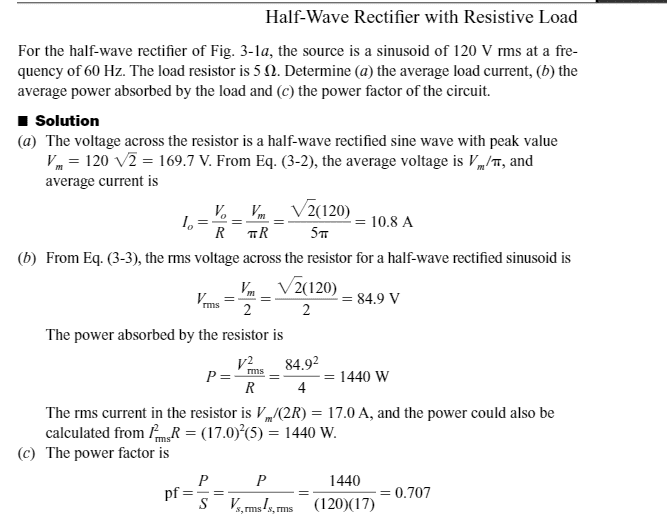

But is it different for half-wave rectifiers then? I'm looking at this example in my book and it's using RMS to calculate the power (part b):
But the output of a HWR is DC too isn't it?
The hwr is a half-sine wave WITHOUT A CAPACITIVE FILTER. Your full-wave rectifier circuit INCLUDES a CAPACITIVE FILTER. The latter is practically like the output of a car battery; the former is a half-sine wave. If your fwr circuit didn't include the capacitor, the rms voltage would be double the half-wave unfiltered output.

I'm sorry but I'm still having trouble understanding. I know what rms means but it's confusing me in this instance.
In a full-wave rectifier without cap filter, the output voltage would be the fully rectified input sinusoid, and the rms would be double the hwr, like you said.
How does that change with a capacitor? It's not a fully rectified sinusoid anymore, but the fwr is still periodic with the period being from when one diode pair is on to when both diode pairs are off (and the capacitor starts discharging), right? Why wouldn't I take the rms of this for power calculations? You mentioned above that 12V IS the rms voltage, but how/why? Do I just assume it's rms when they tell me what the output voltage should be like in this question?

OK, good question. And in fact you're right. The output of your filtered (capacitor added to satisfy the 3% error criterion) is not a pure 12VDC voltage. It's a periodic voltage with sudden jumps of 0.36V (when the diodes conduct) and exponential decays back down 0.36V until the next diode conduction. So it's a voltage with just under 12V average with peak-to-peak "ripple" of 0.36V. If you perform my rms formula you will get close to 12V as the rms voltage - you should try it. Notice that the capacitor size matters a lot, which is why the problem asks you to come up with a value big enough to meet the 3% droop requirement. As you lower the capacitance from this value you will get more and more decay before the next diode conduction event, until when C=0 there is just the fwr rectified sine-wave.

Ohh okay I think I'm starting to get it now. Ideally, a FWR with cap filter would output a pure DC voltage. That's why (depending on the capacitor value) I can use the DC power formulas (P = IV, P = V²/R), even though there's a small voltage ripple. But with a FWR without a cap filter, I need to use AC power formulas (P = V²rms / R, P = I²rms*R) because the output is sinusoidal. Is that correct?
Yes, but keep in mind what i said: rms voltage always gives power = Vrms2/R, no matter what the shape of the voltage waveform. In fact, that's the definition of rms voltage: to give the same power (averaged over 1 or more cycles) irrespective of the waveform shape.
