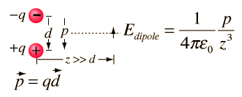

Hi,
I don't understand this:
You got a dipole, and a resulting electric field from it like this(hyperphysics):
As z approaches infinity, the field becomes zero.
But if you draw a gaussian surface round the charges, then the net enclosed charge is zero.So the electric field must be zero, no matter how I draw the surface.
So If i just draw a surface tiny enough to enclose both charges, my z is totally not going to infinity and the field is zero according to Gauss' LAw.
How is this compatible with each other?What is the pitfall in my thinking.
Thanks in advance.
No, the integral of the electric field over the entire surface (the flux of the electric field) must be zero.
On some parts of the surface, the field points outwards, which contributes a positive amount to the flux. On other parts of the surface, the field points inwards, which contributes a negative amount to the flux. The positive and negative contributions add up to zero over the entire surface.

As others have pointed out, Gauss' Law tells us that if a surface encloses total charge 0, then the AVERAGE of the field over the surface is zero. That doesn't mean that it is zero at every point. In the case of a dipole, the part of surface nearest to the + charge will have a positive flux through it, and the part of the surface nearest to the - charge will have a negative flux through it.
Gauss' Law doesn't really help much in figuring out what the electric field is for a distribution of charges unless there is some kind of symmetry involved. So for instance, a flat uniform sheet of charge, a line of charge, a spherical shell of charge.
