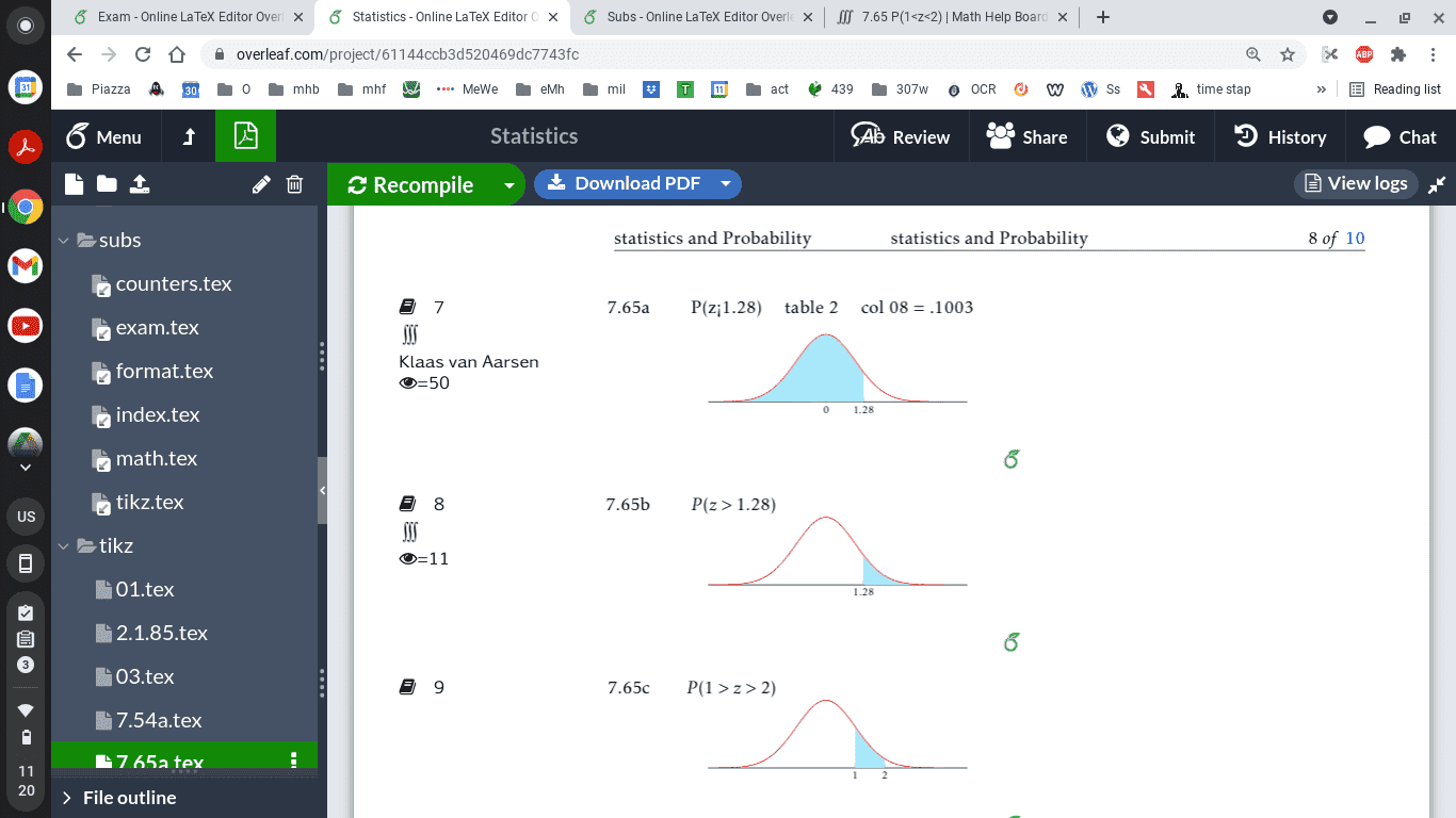

ok this was for P(1<z<2) scaled the graph to .6
the ultimate answer of course is the area in the domain which I don't know if we can derive from the gauss{}{} function
I tried to put the newcommand quass{}{} in the preamble of Overleaf but it didn't take
also thot since all 12 of homework problem are just graphing P()
be nice just have a newcommand \Pg with arguments but also need code that can be colabortive with Overleaf and MHB
again mega mahalo for all the help
this is what it looks like in Overleaf...

Well, with a bit of trickery, we can do:
\begin{tikzpicture}[scale=1,
declare function={
gauss(\x,\mean,\sigma) = 1/(\sigma*sqrt(2*pi))*exp(-(\x-\mean)^2/(2*\sigma^2));
normcdf(\x,\m,\s)=1/(1 + exp(-0.07056*((\x-\m)/\s)^3 - 1.5976*(\x-\m)/\s));
%preamble \usepackage{pgfplots}
\begin{axis}[every axis plot post/.append style={
mark=none,samples=50,smooth}, % All plots: 50 samples, smooth, no marks
axis x line*=bottom, % no box around the plot, only x axis
axis y line=none, % the * suppresses the arrow tips
enlargelimits=upper, % extend the axes a bit to the right and top
domain=-4:4, % Default for all plots: from -4:4
xtick={1,2},
width=10cm,
height=4cm]
\addplot [fill=cyan!30, draw=none, domain=1:2] {gauss(x,0,1)} \closedcycle;
\addplot {gauss(x,0,1)};
\path foreach \y [evaluate=\y as \yeval using {normcdf(\y,0,1)-normcdf(1,0,1)}] in {2} { node[ left ] at (axis cs:{\y},0.05) {\yeval} };
\end{axis}
\end{tikzpicture}
It uses
Code:
[declare function={
to approximate the area under the Gaussian graph.
And it uses evaluate=\y as \yeval using syntax to convert the function call into a value before printing it.
