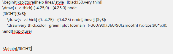

ok founut d this it renders in overleaf but not here
also, transformation is not yet applied

Seems to work for me here.
This is what you posted:
It's what we see when we switch to source mode, the wheel at the right top that looks like this:
Note the [RIGHT] and [/RIGHT] that are breaking up the TikZ code, and which aligns part of it to the right.
Can't have those. If we remove those markers, then the TikZ picture is rendered as it should.
It seems you accidentally aligned some of the text to the right, which happens if we select this option:
