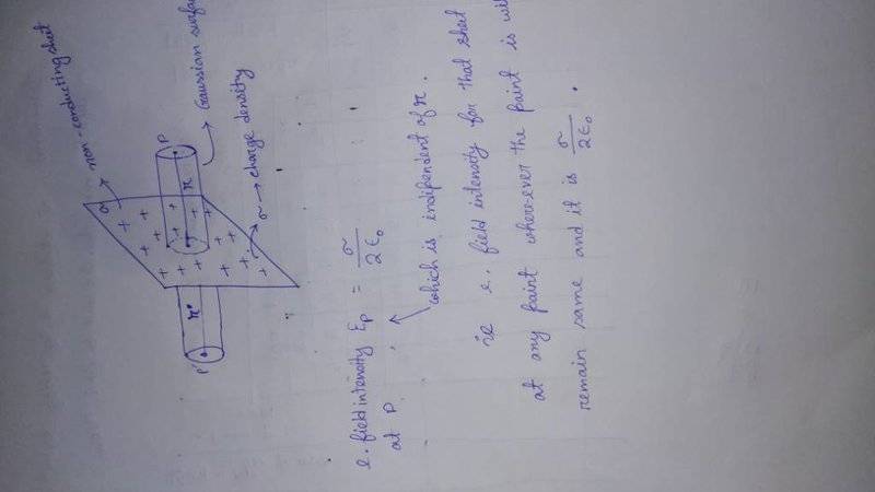

why electric field intensity at a point of a non conducting sheet is independent of r?
Do you understand the derivation from Gauss' law? (You can also just add up all the contributions to the electric field at a point. Same result.)
i m confused. can you please explain it?
Gauss's law is all about the electric flux, isn't it. So the line of force of a charge travel to infinity, so at a point on which we will calculate e.field intensity may lie at infinite distance, also in this derivation we do calculate the derivation by taking 0 rad angle between E and ds, i.e. all the lines of force that we take for calculation are may be perpendicular to that sheet so for those lines of forces the point on which we r going to calculate E doesn't depend on the distance of the point from the surface of the sheet. Am i right?? I don't think...so, Please explain me clearly.
Forget about finding the field "at infinity". The point of this model is that the dimensions of the plate are huge compared to the distance from the plate, so that we can treat the plate as effectively infinite (and thus ignore any effects from being near an edge).
The field at any point is perpendicular to the sheet. Thus the only parts of the Gaussian surface that will have a flux is the end pieces.
Since the amount of charge enclosed -- and thus the flux -- doesn't change with distance from the plate, we can conclude that the field does not depend on that distance.
