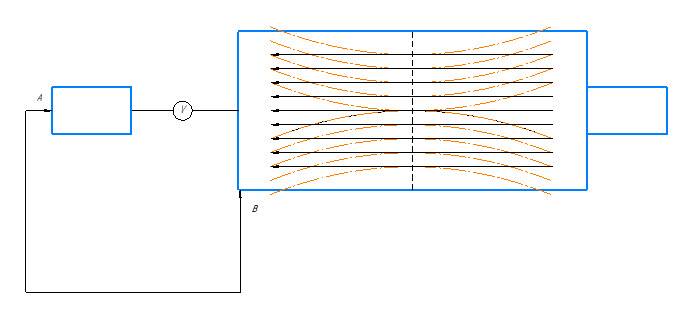

Looks to be nonsense to me.

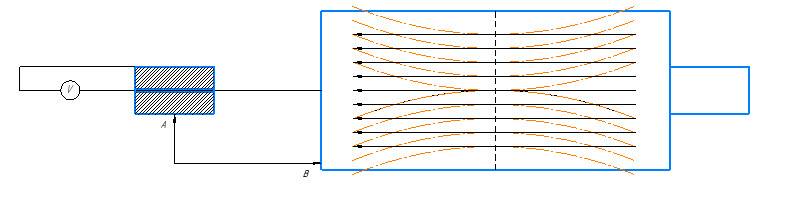

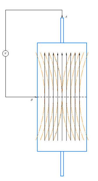

1) The image on the first page shows a magnetic field (B-field) thru the whole of a conducting plate.
2) Fig. 2 on the next page does not indicate a B-field at all.
3) Fig. 2 seems to indicate that the "U" shaped conductor is the part in motion in the B-field.
4) On pg. 2, item 1, at the top of page, states the galvanometer and its connectione are at rest with respect to the B-field.
Unclear:
If the images are accurate, then the description indicates that the "U" shape of fig. 2 is moved in the B-field with sliding contacts to the galvanometer. There appear to be arrowheads where the galvanometer connects to the block.
Conclusion:
The solid block of something conductive in the first figure is being moved in a B-field and the galvanometer is measuring the voltage induced across this block, orthogonal to motion and B-field.
This situation is identical to a DC generator, of which there are many in use around the world.
Have fun with this one!
Tom
The magnetic field lines are perpendicular to the plane of the sheet, they come out of the magnet
The "U" shaped conductor moves outside the magnetic field
Right. In this model, the galvanometer is transferred to the reference frame of the conductor and, together with it, is fixed in the laboratory. Only the "U" shaped wire moves, which is not in a magnetic field.

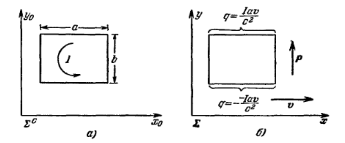

Two-panel diagram: left, a rectangle with sides a and b in the x0-y0 plane with a circulating current loop labelled I, frame Σ^c; right, the same rectangle moving with velocity v along x, with charge densities q = Iav/c^2 on top and q = -Iav/c^2 on bottom, and a vector p pointing up.

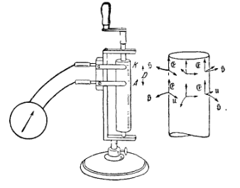

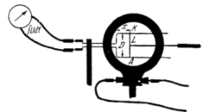

Diagram of a Faraday disc-style apparatus: a ring-shaped conductor between magnet poles with radial leads running to a galvanometer on the left, with labels K, L, D and A along the ring.

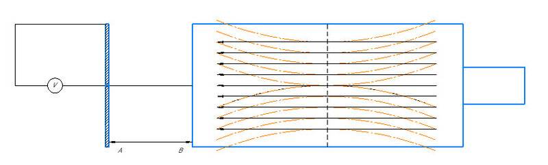

When the motor L moves, an electromotive force appears. I suggest moving not the L engine, but an external circuit that is not in a magnetic field. In this case, the galvanometer (electrical load) is transferred to the reference frame of the conductor (motor L). In this case, we get the same electromotive force, but the Ampere force does not act on the external circuit, because when it moves, it is not in a magnetic field.

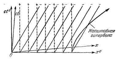

Minkowski spacetime diagram with axes ct and x, and primed axes ct' and x'. Vertical dashed lines and slanted lines cross the grid, and a bold hyperbola is labelled with Russian text meaning scale hyperbola, with origin O marked.
An electrically neutral current loop in its own reference frame does not have to be neutral in another inertial reference frame. Using the Minskovsky diagram, it is proved that the charge densities are different in different frames of reference, precisely as a consequence of the relativity of simultaneity.

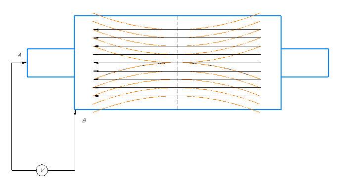

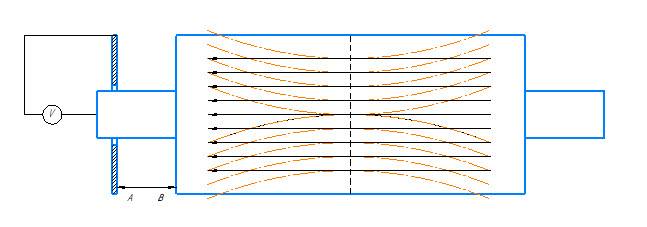

This diagram in your post #26 does not match the diagrams in your post #5. Please clarify.
Post #5 shows a laboratory setup to demonstrate the production of an electromotive force when an external circuit moves, which is not in a magnetic field. Post #26 shows the Minkowski diagram, which proves that there is a difference in charge density in different reference frames.
My bad, I intended to compare you post #25 to your post #5.
The installation in post #5 is based on the installation in post #25. The galvanometer has been moved to the reference frame of the L engine and is electrically connected in series (in a circuit break). Instead of an inductor, neodymium magnets are used, the field of which is oriented in the same way. Moving the "U" shaped conductor to #5 is equivalent to moving the external circuit to #25.
