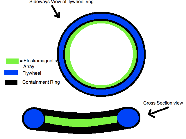

Ok so I just had a bit of a eureka moment. Conventional battery flywheels are not made to be portable (gyroscopic forces make this quite difficult). This can be offset with gimbaled systems, negating the gyroscopic effects that occur in a fast-moving flywheel. However, these types of systems are often bulky and require a lot of space. My solution: build the flywheel into the gimbals! Picture this: a tube, bent to form a ring. This ring has a series of electromagnet arrays spaced out along its length. Within this ring, we put another ring, this one solid. This new "inner-ring" is our flywheel. Any comments/suggestions?
How is the middle ring suspended? Just by a normal gimbal arrangement?
Thats what I'm picturing yes.
Some sketches would be nice. I'm having a bit of trouble picturing it.
Hehe I like that. I'll do up a quick sketch and have it up by tomorrow. How do I post pictures?
Oops, ok, I just read up on the forum rules and discovered that I'm not allowed to post pictures. I can email it to whoever is interested in seeing it though, through attachment. The best way I can describe it is as a ring within a ring, attached in the normal gimbaled-arrangement to another ring within a ring, and so on. The outer rings would have electromagnets along their lengths, able to spin up the inner rings to sufficient speeds.

Ok here is a quick diagram I did up not too long ago. Its rough, I'm working on a mac and I had to download a paint program which I'm not too family with (quite buggy :S).

Nice picture, but I'm still a bit lost here. How is it attached to whatever it's attached to? I don't see any axles or studs or anything there.
More importantly, what makes it spin? If you're thinking of it working like a linear induction motor bent into a circle, your 'flywheel' can't be solid. You'd have to have alternating N & S magnetic domains for the electromagnets to work against. Maybe I'm missing something? :confused:
Sorry, I just thought to include the single flywheel in my diagram. If completely assembled it should look something like a gyroscope in a box, the box being the support structure for the gyrsocope. The rings would move about freely (like in a gyroscopic) whichever way the forces are acting on them. On the matter of actually getting the flywheel to spin, I am not familiar with electromagnets and their workings. I just assumed that maybe the core of the flywheel itself could be composed of alternating north and south magnetic domains, and that this would be the most efficient way to speed the flywheel up. I'll try and post another picture.
Does anybody have an idea as to what types of equations I need to use in order to figure out the energy capacity of a ring-like flywheel? Are they more or less the same as a traditional disk based flywheel?
The kinetic energy of a rotating flywheel = 1/2 I w^2
w = (omega really) rotation rate in rad/s
I ( moment of inertia) depends on the shape, generally it is of the form =constant * mass * radius^2, so the more mass and the bigger the radius the more energy. For a loop I = 1/2 m r^2
It's fairly easy to derive but there is a list for common shapes http://en.wikipedia.org/wiki/List_of_moments_of_inertia.
