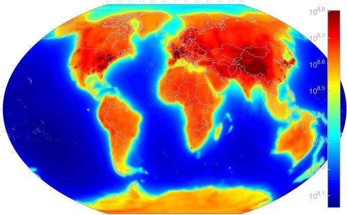

A group of scientists used geology models and data about nuclear reactors together with results from two neutrino detectors to produce a worldwide map of antineutrino emission. Man-made reactors are contributing 1% to the total emission, but the production is so localized it is clearly visible in many spots.
Original publication
phys.org news
Next step: actually measure this...
Could be interesting to monitor nuclear reactors from everywhere in the world, but that would need a very good angular resolution of the detectors.

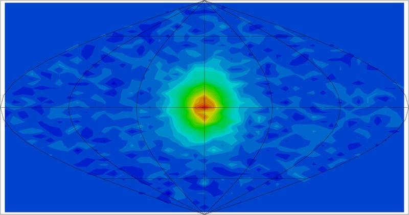

Unfortunately, since this is what the sun looks like in neutrinos (in Super-K), I don't have too much hope of there being the resolution to measure this any time soon. :sorry:
Why the huge difference (factor of 5) between land and sea?
Presumably the differential distribution of U/Th in the oceanic vs continental crusts. Continental crusts are enriched in U/Th relative to the ocean. http://www.world-nuclear.org/info/Nuclear-Fuel-Cycle/Uranium-Resources/The-Cosmic-Origins-of-Uranium/

Wikipedia says the continental crust is roughly 5 times as thick as the ocean crust. Could it be as simple as that?
Not really. It is a difference in elemental composition that matters. The continental crust is more enriched in the long-lived radioisotopes (U,Th,K).

France is pretty high, which is not too surprising. A large part of western China and Mongolia is too.

The present-day abundance of uranium in the 'depleted' mantle exposed on the ocean floor is about 0.004 ppm. The continental crust, on the other hand, is relatively enriched in uranium at some 1.4 ppm. This represents a 70-fold enrichment compared with the primitive mantle. In fact, the uranium lost from the 'depleted' oceanic mantle is mostly sequestered in the continental crust.
It is likely that the process or processes which transferred uranium from the mantle to the continental crust are complex and multi-step. However, for at least the past 2 billion years they have involved:
  1. formation of oceanic crust and lithosphere through melting of the mantle at mid-ocean ridges,
  2. migration of this oceanic lithosphere laterally to a site of plate consumption (this is marked at the surface by a deep-sea trench),
  3. production of fluids and magmas from the downgoing (subducted) lithospheric plate and overriding mantle 'wedge' in these subduction zones,
  4. transfer of these fluids/melts to the surface in zones of 'island arcs' (such as the Pacific's Ring of Fire),
  5. production of continental crust from these island arc protoliths, through remelting, granite formation and intra-crustal recycling.
