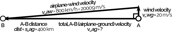

An introductory picture.
Its number in my physics exercise book is 1.147. (just for reference, though completely unimportant). The actual problem description is written below.
An airplane is flying from point A to the point B which is 400 km west from the point A. Determine how long was it flying if:
  • there was no wind;
  • a wind was blowing from the east;
  • a wind was blowing from the south?
Wind's speed is 20 m/s, and airplane's speed with regard to air (wind) is 800 km/h.
Just as in The Classic Airplane Problem, laws of sines, cosines, tangents and cotangents, and the Pythagorean theorem.
Distance of 400 km between points A and B is assigned to variable dist, wind's speed has a variable name of v_wg (meaning velocity, wind-ground), airplane's speed with regard to air (wind) goes by the name of v_aw (airplane-wind velocity), and the resultant velocity is named v_ag (velocity airplane-ground).
  • No wind, hence time t is equal to the dist / v_aw ratio, where v_aw when converted to metres per second equals 2000/9 m/s. The final result for this part is t = 1800 s.
  • There is a wind, and it's contributing to the airplane's speed, thus:
    v_ag = v_aw + v_wg.
    v_wg is 20 m/s, so the sum is 2180/9 m/s ... and t = dist / v_ag ≈ 1651,3761 s.
  • There is a wind, and it's blowing from the south. I used two triangles to visualise and try to solve this problem. The right angle is placed in the upper right corner. On the top is the upper cathetus whose value is dist (or s_aw), on the hypotenuse is s_ag, and on the right leg (cathetus) is s_wg. Same naming convention and layout applies to the second, "velocity" triangle.
    1. First (still the c part of this exercise), we don't have much informations about the distance part, so let's go on the velocity triangle. Calculating the hypotenuse by the Pythagorean theorem, v_ag is approximately 223,1204 m/s.
    2. Calculating the angle between v_aw and v_ag by the cosine relation, got approximately 5,1428 degrees.
    3. Going back to the distance triangle. Now that we've got the angle between s_aw and s_ag, we can calculate s_ag. Using the cosine relation, the result is about 401616,7551 m.
    4. t = s_ag / v_ag ≈ 1800 s.
The book tells me that the a and b parts are solved correctly, while the c part is messed up horribly.
The problem lies in the fact that I've set v_ag as the upper cathetus, but according to the book's logic, or at least as I see it, it should be the hypotenuse. Swapping v_ag and v_aw on the velocity triangle and using the dist distance gives the correct value book author specified (30,12 minutes), or by dividing s_ag calculated in step 3 of the c part with the v_aw value. I can simply swap the values and do so from now on, but I'd like to understand the reasoning behind it. Is it because it's really going along the upper cathetus (the dist path), but at a speed of the hypotenuse or ... I don't know. Help!

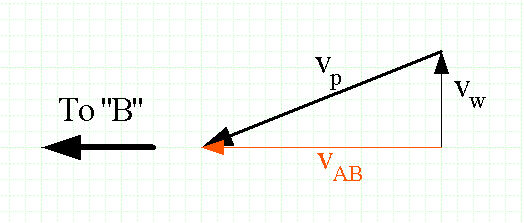

Start by drawing the wind velocity as this is something you know completely. Then draw a horizontal line from the base of the arrow representing wind velocity to represent the total velocity since you know that it has to be due west. Now you have to draw the aircraft velocity relative the wind. It has to be an arrow with length 800 km/h that starts at the tip of the wind velocity and ends somewhere on the horizontal line you just made. The total velocity is a vector from the base of the wind velocity arrow to the tip of the airspeed velocity arrow. Do you get a right triangle? Which velocity is the hypotenuse in it?
The alternative is adhering to the other suggestion you got. Total velocity is the aircraft velocity plus wind velocity and must have north-south component zero. This gives a requirement on the north-south component of the aircraft velocity. Since you know one component and the absolute value, you can solve for the second (westward) component. Since the wind has no east/west component, the total velocity is just the westward component of the aircraft velocity.
gallathus said:
Thank you for replying so fast!
gneill, I understood the fact (well, somewhat I did) that the airplane has to deploy a part of its velocity to compensate for the wind's force. However, what bothered me was its calculation, what goes where? So ... the horizontal component should be, if the vertical is equal to v_wg and the Vp is under a (for now) unknown angle, approximately 221.3204 m/s?
Yup.
gneill, so VAB is the effective velocity (speed) vector?
Something like this?
It's drawn in Inkscape, not some strictly math or physics oriented program, so expect minor inaccuracies. Assuming that I've followed your instructions properly ('tis all new to me, so sorry if I failed somewhere), the hypotenuse's magnitude is equal to airplane's speed relative to wind (hope I've used the physics/maths terminology properly here :p).

gneill, so VAB is the effective velocity (speed) vector?Something like this?
Yes, VAB is the plane's net velocity vector with respect to the the ground.
Well, okay. I believe I've expressed such a concept in the concluding part of my first post, just not by these words. However, regardless of perception and the way you interpret the task, it all, as far as I can see, boils down to setting v_aw as the hypotenuse, v_wg for the right cathetus and calculating the v_ag out of that. All I'm missing are the whys and hows. Correct me if I'm wrong.
The whys and hows flow from the understanding that, as far as the airplane is concerned, wind doesn't exist; there's just a big sea of air that the plane moves through at its rated speed with respect to that "still" air. Wind is a concept of the sea-of-air moving as a whole with respect to some observer on the ground. Because the sea-of-air is moving with respect to the ground, an observer there has to add the plane's velocity vector with respect to the air to his own wind velocity vector in order to determine the net velocity of the plane in his frame of reference (the ground).
No, not something like that - exactly that ;)
