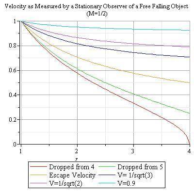

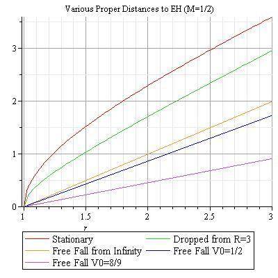

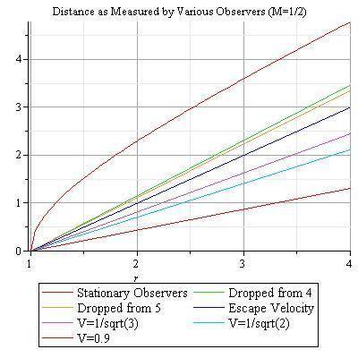

pervect said:
The distance to the event horizon in Fermi Normal coordinates is NOT simply the value of the Schwarzschild R coordinate.
Well it should be very simple to resolve this issue as we can have a little coordinate independent numerical example and plug in the numbers and see where the differences are.
We take M=1/2 and we have a space station at a proper distance of 1 from the EH. A free falling (from infinity) probe is passing by and just when this probe is at the same r value as the space station the captain of the probe reports his observed distance. The captain of the space station reports the observed velocity of the probe.
So we have:
M = 1/2
Proper Distance Space Station: 1
I get:
Schwarzschild radial coordinate of the space station: 1.232270555
Observed distance to the EH by the probe: 0.232270555
Velocity as observed by the space station: 0.9008385532
Lorentz Factor: 2.303328900
So do you get the same if you calculate the problem by using Fermi normal coordinates? If not, what do you get?
By the way if you have an objection to measuring the distance to the EH, an objection which I do not share by the way, then feel free to calculate it up to the EH+epsilon.
Edited: update the probe distance.

Here is a plot where we can compare three distances (for now I just called the distance you calculated "Fermi Distance"):
  • #54
So we have:
M = 1/2
"Proper" Distance Space Station: 1
I get:
Observed distance to the EH by the probe: 1.232270555
Are you sure that the "passionflower distance" to the EH is 1.232270555? I would think it would only be .23227, i.e. 1.2322 - 1
I agree that the fermi-normal distance from the space station at r=1.2322 to the event horizon is equal to 1.
The fermi-normal distance from the probe to the event horizon when it passes the space station is somewhere between .243 and .244
This is clearly not equal to your number (or your number -1).
This is found by solving numerically the differential equation for r(s), i.e.
dr/ds = -1/sqrt(1+1/1.2322 -1/r) with r(0) = 1.2322, and finding the value of s for which r(s) = 1.
I agree that the velocity of the probe relative to the space station is 1/sqrt(r) = .9, approx, and that the gamma factor is 2.3.
So, the numerical example confirms that passionflower distance is not equal to the Fermi-normal distance.
