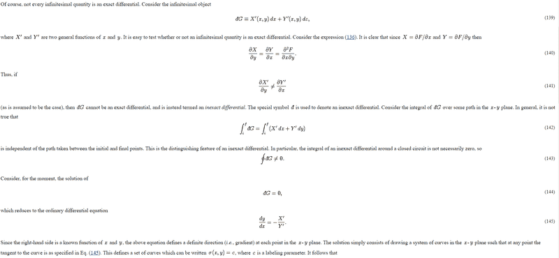

How is equation 145 giving a direction(ie gradient) and not a slope?.

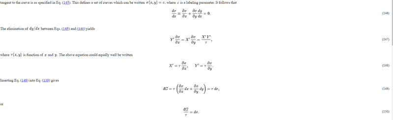

Also here
Scanned page of equations (146) to (150) on a curve-family labeling argument: dσ/dx = ∂σ/∂x + ∂σ/∂y dy/dx = 0; then Y' ∂σ/∂x = X' ∂σ/∂y = X'Y'/τ; X' = τ ∂σ/∂x, Y' = τ ∂σ/∂y; dG = τ dσ; dG/τ = dσ.
how is equation 147 arrived at?

granzer said:
In
How is equation 145 giving a direction(ie gradient) and not a slope?.Also here

I can just barely read the images you posted.
For your first question, in the US, we tend to call ##\frac {dy}{dx}## a slope; in Europe, people tend to call this a gradient. I prefer to reserve the term gradient to functions such as this: If z = f(x, y), then ##\nabla z = (\frac{\partial f}{\partial x}, \frac{\partial f}{\partial y})##
If y = 3x, then y' or (##\frac{dy}{dx}##) = 3. This gives a direction in the sense that from any point on the graph of this line, you can get to another point by going right 1 unit and then up 3 units.
Same idea for your second question.
@Mark44 Hello Sir,
Thank you so much. The answers u gave have cleared my doubt about equation 147 and I completely agree with you. I was wondering if it should be given as a slope. And yes going right 1 step and going up 3 step gives a direction from the point. But it is also true going 3 step down and one step back we can get another point. So the direction is both front and back and not a particular direction that would be given by a gradient. But if we take gradient to mean slope here then my doubt is cleared.
But with regard to eq 147, it is given:
##∂σ/∂x=X'∂σ/∂y=X'Y'/τ##
I am not understanding how #X′Y′/τ# is got here.
Any clarification on this would be really helpful.
