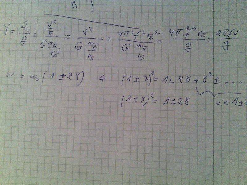

I will get right into it by saying, how can i prove that :
w=w0*(1±4πƒv/g)​
Where "w" is the weight of an object moving along the ecuador, v is it's velocity and g is the gravitational acceleration.
I have tried to calculate the centrifugal/gravity acceleration ration by deviding at=v2/r over g=Gm/r2, and i got that it equals 2πƒv/g instead of 4πƒv/g i have no idea where to go further than this other than put all this in a binomial equation and come up with an exponent that will give the (1±4πƒv/g) parameter.
Thank you in advance.

here is the calculations i did, its so poor and lacks logic i just followed guts feelings
  • Handwritten derivation on grid paper: gamma = r_E/g = v^2/(G m_E/r_E^2) = v^2/(G m_E/r_E) = 4 pi^2 f^2 r_E^2/(G m_E/r_E) = 4 pi^2 f^2 r_E/g = 2 pi f v/g, then omega = omega_0(1 +/- 2 gamma), with (1 +/- gamma)^2 = 1 +/- 2 gamma + gamma^2 +/- ..., and gamma^2 marked much less than 1.
Acceleration relative to the ground does not go into that formula at all.
Yes, it lacks logic, and there is no explanation either, which makes it hard to impossible to understand what you did.
i thought g(r) = G m(r)/r2
what i did is to show that, that 4πƒv/g is the tangential acceleration/gravitational acceleration ratio and the weight of any object moving along the ecuador with a velocity of v should change with respect of that formula, i think i should work more on this i can't find anything else on the internet and the exercise is in german.
It is not.
