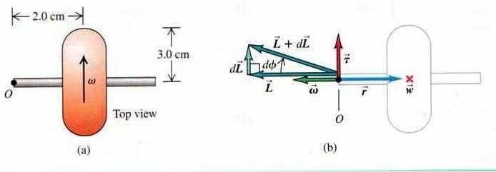

Hi,
It asks me to state whether the direction of the gyroscope precession is clockwise or counterclockwise (see attachment). I am confused as to how they determined from the top view (on the left) that the direction of angular velocity and angular momentum were pointing towards the left. They don't explain it at all.
Any thoughts would be greatly appreciated. Thanks so much!

rleung3 said:
Hmmm, nope, there isn't any equation that describes a vector for precession.
The diagram on the left is perhaps confusing. The ω shown there is not the vector ω. It is showing the direction of rotation of the wheel. The direction of the ω vector is along the axis of rotation, in a right-hand sense. The arrow labeled ω in the diagram on the right is in the proper direction. For objects spinning on a symmetry axis, the angular momentum L is in the direction of ω as shown in the digram. An applied torque causes the angular mometum to change in the direction of the torque at a rate that is equal to the torque. As L changes direction, ω also changes direction and remains parallel to L.
Torque is also a vector whose direction is along an axis. To produce the torque shown in the diagram, you would have to push the right hand side of the wheel axle into the page, or pull the left side out of the page, or do both at the same time.
The change in angular momentum shown in the diagram is very exaggerated, but it shows that the direction of L changes in response to the applied torque without changing the magnitude of L. As soon as L changes a little bit, everything else changes direction too. The L vector sweeps around with constant length, and the ω vector also sweeps around with constant length. This phenomenon is called precession.

Thanks so much OlderDan.
So, the thing I am still confused on now is...can you look at the diagram on the left and automatically "translate" it into the diagram on the right-hand side? The book gives off the impression that you can, but I am confused as to how.
Thanks again.
Ryan

There is nothing in the diagram on the left to show that a torque is being applied. If they told you about the torque, then you could create the diagram on the right.
