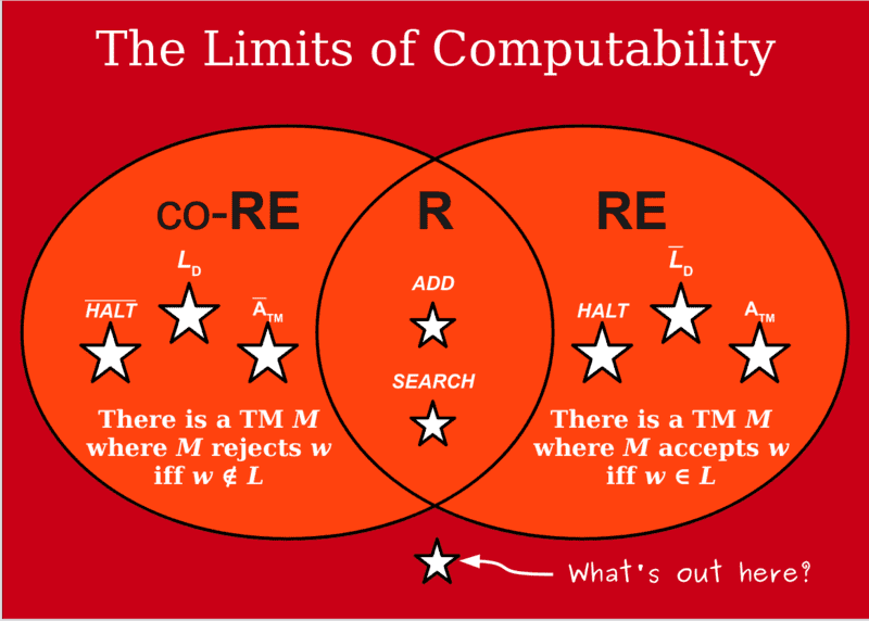

These type of problems you mention are called recursively enumerable (where we can be sure we will find the answer if it is a yes), but not co-recursively enumerable (where we can be sure we will find the answer if it is a no). It means we can only solve it if it's a yes answer (e.g. has a solution). The Halting problem is another example (we can always figure out it will Halt if it does eventually halt, just by keeping it running, but it might run forever and we won't know if it is going to or not) and another example is finding solutions to diophantine equations. This was Hilbert's 10th problem.
https://en.wikipedia.org/wiki/Diophantine_equation#Hilbert's_tenth_problem
Now, going back to the issue of completeness and ZFC, suppose that a diophantine equation doesn't have a solution. This is a problem that is either true or false. But, since it's not co-re, a proof exists that shows it has or doesn't have a solution only if it does have a solution. So saying that some such an equation does or doesn't have a solution when it in fact doesn't is a statement which is independent of ZFC. So, essentially, this result also proves Gödel's first incompleteness theorem.
There are also problems which are neither re nor co-re problems. But a problem is only decidable if it is both (you need to be able to answer both the yes and no, e.g. if it has a solution you need to determine that, and if it has no solution you need to be able to determine that also). So undecidable doesn't mean exactly what it sounds like.
The reason examples like the Halting problem are so pivotal, is that we can do something called reductions, where we reduce one problem to another, meaning for example, we could show that if we could solve some problem, ##P##, we could use that algorithm as a sub-routine to solve the halting problem. If we do show that, then we know that ##P## is undecidable also. The halting problem is a very easy foundational example of such problems, which allows us to keep discovering new undecidable problems easily.
https://web.stanford.edu/class/archive/cs/cs103/cs103.1134/lectures/20/Small20.pdf
https://web.stanford.edu/class/archive/cs/cs103/cs103.1134/lectures/21/Small21.pdf
