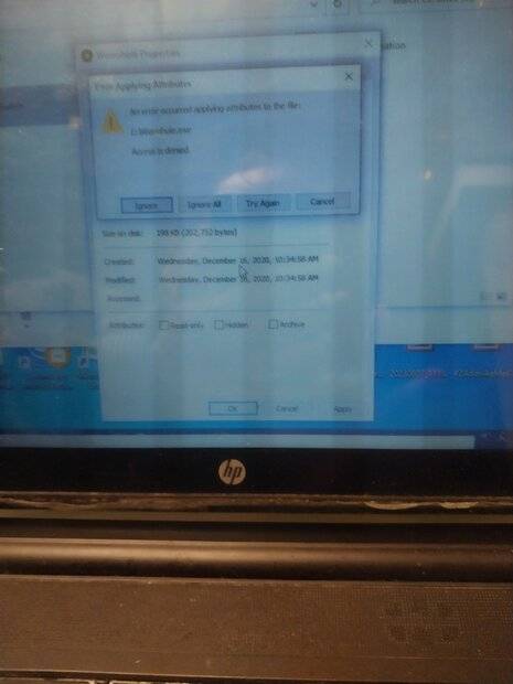

Hi,
So, I'm the only user of my PC, I pwn the Admin account, yet I'm being denied permission to run an executable when clicking on an .exe. Im told I need Sudo-level permission( Is that like being a Super user?). It seems like a collection of processes or data objects are considered accounts that I, the admin, have no control over. I mean, what kind of Admin account is this?
Right click on the file, select properties and the the Security Tab. You can take ownership or give yourself full access.

Thank you, I tried. I need to get the .exe to run, but it won't when I double click on the program icon *. When I look in ' Properties', I see the file is marked/checked as a read-only. I de-select/uncheck the read-only option , apply, then I'm told I need admin permission . I click 'Ignore', apply. But after that, the file, the .exe won't even open up, and thus won't run.

Issue seems I can't override the fact that file has been selected by default to be a read only, and I can't change nor acquire permission to override that. System hasn't let me thus far.
Upon doing some reading on permission-related issues, it seems my difficulty has to see with heightened security implementation to reduce the odds of being attacked.

I did state that you could take 'ownership' of the file. That's different from just having permissions. Sometimes you have to take ownership in order for it to work. However, I would be very cautious about doing it for anything important like OS files.
There is a huge amount of confusion here.
In order to run a file as administrator you right click on it and select "Run as administrator". You will then be asked to confirm this with a dialog asking "Do you want to allow this app to make changes to your device" and giving you some information about the file. If you select "No" then the action will be cancelled and nothing will happen, so you need to select "Yes".
Whatever you choose it does not change the read/write status of the file, nor is your choice permanent - if you want to "run as administrator" again then you need to go through this process again.
You do not need, or want, to change it's status to "read/write", making exe files writeable has absolutely no impact on whether they can be executed whether as an ordinary user or with elevated permissions.

I think you're not understanding the situation. I may have expressed myself poorly. For one " Run as adminstrator" is not implemented by the PC, which is hardly in top shape. After selecting it, it has no effect. Upon looking up' properties 'of the same file again after selecting " Run as Administrator", the file wont run; the option of " Run as Administrator" remains, i.e., it hasn't been implemented, and it still doesn't allow me to override the fact that the file is " read only", so that it can't be executed. Without being able to de select the option " Read only", the file can't be run , which is what I'm aiming for.
Selecting "Run as administrator" does not change any properties.
You wouldn't expect it to.
Being read only doesn't stop a file from being run.
That is not correct.

Are you trying to install the Wormhole App for transferring files? I'm not sure what the file you are trying to run is, but AFAIK the only way to install Wormhole this app is via the Microsoft Store: https://apps.microsoft.com/detail/9NNQV0RM2J9R.

The J5create JUC400 Wormhole USB transfer switch is a device that allows drag & drop file transfer, keyboard and mouse sharing, and clipboard sharing. When you plug it in, it starts a virtual CD drive, from which it installs a temp program called wormhole.exe (and supporting files -- you can see the programs as background tasks in task manager -- the properties dialog shows the location and the program file names; navigating to the directory/location will allow you to see all the files).
When you are exiting the Wormhole Switch app, it asks if you want to uninstall -- if you decline, or just remove the cable, or if the uninstall fails for some other reason, some or all of the temp files will remain installed, and if you try to delete them manually, you will get the access denied messages for some of them due to not having active permissions for them. The wormhole.exe program is not designed to be invoked directly; the product has a launcher program for the purpose
The device can be convenient and useful, but it is not fast enough for bulk data transfer -- better would be, as others have suggested, to back up the HDD to a network or a local external device.

Selecting " Run as Administrator " is having no effect, i.e., it's not actionable. PC does not respond with a dialog box prompting me to choose. No such dialog asking me whether I want to allow the app to make changes. That just is not happening when I click on " Run as Administrator ".Like I said, this PC is on its last days, and I need to use a virtual keyboard to type in instructions. This is not your average case scenario.
I believe Sysprog figured out what was happening. I was trying to access auxiliary files in the program folder left over from the installation, over which I had no control. The executable was not in sight. As Sysprog explained, the executable is not invoked directly; there is a launcher program that brings it up. So there's no executable in the program folder. I didnt know this and I was trying to use the auxiliary files to run the program, files I have no control/ownership over. Now that they're installed there, they're just a nuisance I must get rid of.
I guess " Run as Administrator " has no effect since , given there's a launcher program that runs in the background and no executable, there's really nothing to be run.
