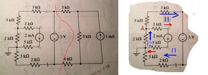

Hard intro circuit problem help please im stuck on this one for hrs

http://imageshack.us/photo/my-images/585/circuitzzz.png/

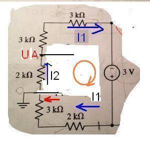

i thought maybe i should ignore everything that is on the right side of the 3v and just focus on the left side. but this one is not looking too good for me.

One way to sort your head out about this sort of problem is to redraw the circuit in a way that makes more sense to you. Since there is an explicit ground in this diagram, it may help to draw a ground rail across the bottom of the page and draw the other components in above that ... i.e. the ground rail has three resistors connected to it...
find volt across the 2mA source

how many mesh loops do we have here??

Yes, it is a good idea. See picture.

A fair few - but you don't need all of them.

I1 = V/R
Resistors add up right?
I1 = 3/3+3+2+3+2

No.
Only resistors in series add up. There is I2 current flowing through the left 2kΩ resistor. It is not in series with the other ones.

Write KVL for the loop in the figure, and substitute I2 = I1+2

applying KVL = 6I1 - 3 +5I1 + 2I2= 0?
yes.

Look at the loop with the current source. What are the voltage across the resistors?

No, I2 flows through the vertical 2kΩ resistor only. The others have the generator current.And your I2 is not correct. Write up KVL again for the loop in the figure. The voltage drop across the generator is Ug. Determine Ug.

It is wrong. Write the voltages. What current flows through the 1 kΩ and 5 kΩ resistors? What is the current through the 2 kΩ resistor? ehild
