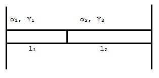

Two rods of different materials with coefficients of linear expansion α1 and α2 respectively; Young's moduli Y1 & Y2 respectively; of initial lengths l1 and l2 respectively are joined at one end. the free ends are fixed to two vertical walls as shown in the fig.
Temperature of the surrounding is then increased by T°C. Find out the displacement of the joint of the rods.
My work
Since my physics is not good so m not pretty sure about what i am applying..
but as i remember my friend guided me once to work on such questions..
I considered the displacement of the joint (say 'x') in any direction (right or left).
Now, x = Δl1 - Δl2 and,
k1Δl1 = k2Δl2
where, k = YA/L , "bulk modulous"
but the two eqns. only are not proving helpful.
If someone could guide me on this question.
Answer is.
x = l1l2(-Y1α1 + Y2α2) / (Y2l1 + Y1l2)

When the rods reach an equilibrium (that is when they stop expanding) what can you say about the force on each other at the interface?

Consider one rod in isolation, heated, and compressed by a force F. Obtain an expression for its change in length. Do the same for the other rod, same F. Writing that the total length does not change should give you three equations with three unknowns.

In your first eqn, you seem to have set the force so as to entirely compensate for the change in length due to temperature. If so, that won't give the right answer, since the two rods will need different forces. Pls try to follow the scheme I described.

No. Just think about one rod. write an expression for its expansion, given the temperature change, and another for its compaction, given the force F. Then do the same for the other. What you know is that the sum of the two expansions equals the sum of the two compactions.

1st rod, initial length l1, coefficient of linear expansion α1, heated by T degrees. For eqn see http://en.wikipedia.org/wiki/Thermal_expansion#Coefficient_of_thermal_expansion, the linear part.
What is the change in length?
1st rod, initial length l1, elastic modulus Y1, subjected to a compressive force F. Assume cross-sectional area is A (this should cancel out later). For eqn see http://en.wikipedia.org/wiki/Young's_modulus#Calculation. What is its change in length?
If both of the above are done, what is the total change in length?

My first qn was in relation to the thermal expansion, but you've addressed the 2nd one:
exuberant.me said:
for rod 1 when it is stretched by a distance x
[itex]F = \frac {Y_1Ax}{L}[/itex]
The force compresses it, so the change in length will be negative. You need to rearrange the equation in the form: change in length due to force F = ΔLF = (some function of F, Y, A, L).
For my first question, you need an eqn in the form:
change in length due to heating T = ΔLT = (some function of T, σ, L).
so change in length is,
l1' - l1 = x (because I've assumed that the joint gets displaced by x
No, we're not ready to think about the displacement of the joint yet. We're dealing with changes to one rod in isolation, due to some force F and temperature change T - that's all.
